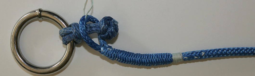

Another idea is something like this where you keep a pigtail with knot attached to your headboard and make a slipping eye splice on the end of your halyard:
Likes: Hayden Watson
