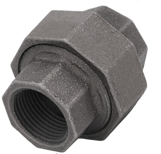

Works if you have the room for the valve... In my case, I'd need a Tee and a valve for my case. I definitively don't have room for all that.
Do you know of marine grade couplings like they use in steam pipes? I've only found these in cast iron, never in stainless or bronze. That would be useful if they were in a marine grade alloy. Put a hose nipple in each end and Bob's your Uncle!

That is a pipe union, and they are commonly available in brass, stainless, bronze, and copper. McMaster Carr has a nice selection in bronze.
Sometimes a little re-piping is required, but then it is done for all time and winterizing becomes a breeze. I added Tees and valves to my cruising cat for the intake to the head, freshwater right after the tank, AC intake, and engines. I could winterize all of the systems, intake to outlet, in less than 30 minutes, going slow. So much better. I even left the suction hoses in place, so that I could just walk from place to place with the AF jugs. So nice, and you never miss a spot.
Nice ! I may have room to plumb in a union. I don't have a lot of room. But I will look for that - thanks for the link. I do have valves in all other location where appropriate.

Please correct me if I'm wrong, but since a pipe coupling is a sort of compression fitting with a softer metal sealing surface, aren't they technically a one time use item? Perhaps a cam fitting or a quick release for hydraulic lines would be a better choice?
In some theory, yes. In over 100 years of practice, no, they are commonly opened and closed, including high/moderate pressure (much higher than any pressure on a boat) applications, where anual or similar service is required. Not something where they are opened every week, but every year is not unusual. They might wear after a few decades of this use, at which time they are not hard to replace. The suggested boat use is VERY light duty for these fittings. In industry they might run at 200 PSI, 400F, for 10 years, with occasional openings for service.
And I don't have anything against camlock fittings for many applications. But I am sure that the likelihood of a catastrophic leak (anything more than a few drips) is lower with a union that with the other options. (Decades of refinery expereince with many types and many liquids.)
Do heavily grease the coupling threads. Do hold the pipe-end motionless with another wrench when closing the coupling.
