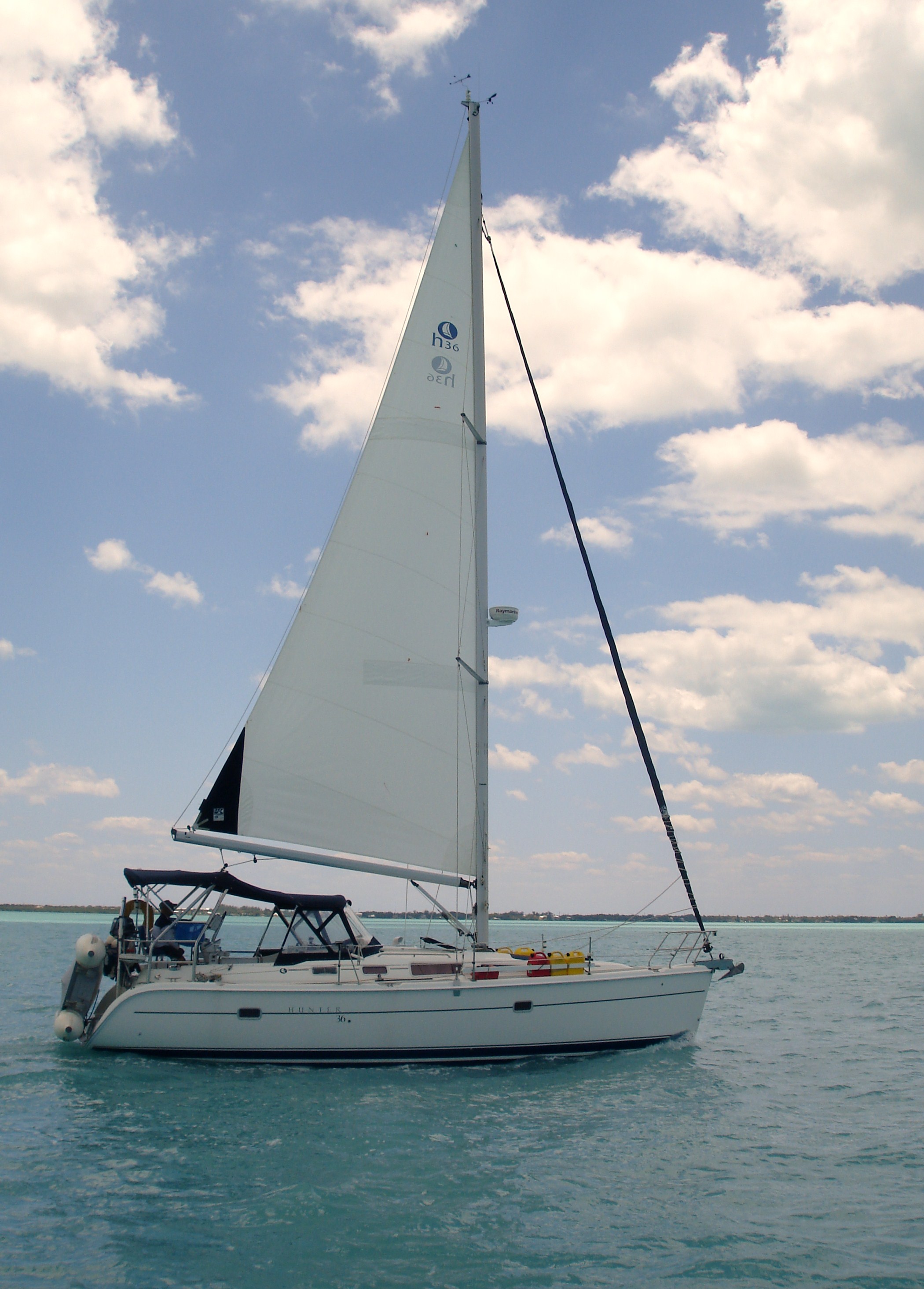

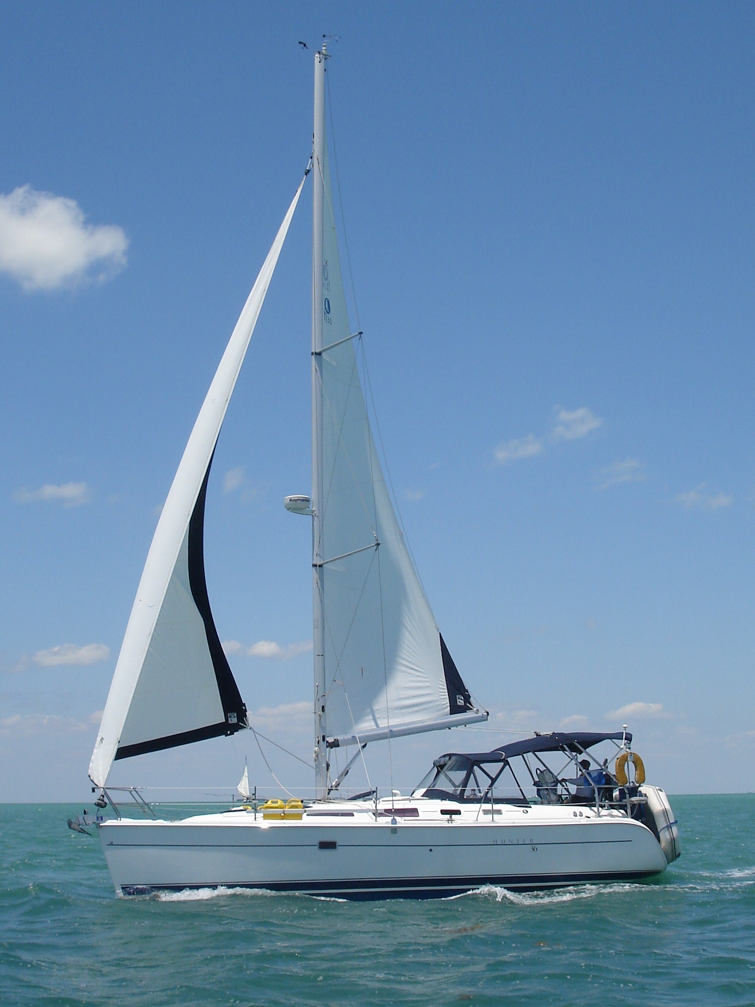

I use a wood board from Stanchion to stanchion on each side and tie jugs to this board for carrying extra fuel.
I used this board to hold 6 jugs when I sailed from montauk NY to Punta Gorda 7 days out on in ocean in 2008 and still use it when ever I go cruising here in SW Fl. and everything is still everything the same jugs and wood boards

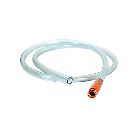

Yup, I've used a shake siphon offshore in 10 foot seas. I put the can on the stern seat and it's perfect.
The only issue I have had is doing this in the rain. I had to do this last Sunday as I ran out of fuel on the ICW in the rain:banghead:.
Black Smoke?
It is difficult to transfer fuel and prevent rainwater from getting into the fuel fill.

Nope. Super easy. I never put fuel directly into my tank. It always goes through a separation filter first. Currently I am using a Mr. Funnel.
