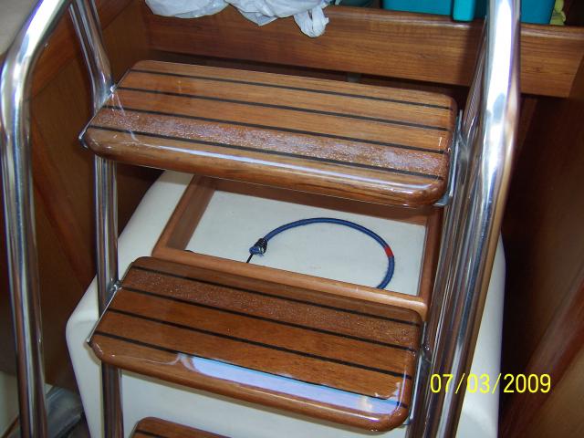

Honey Teak. It has a slight tint but not as dark as Cetol. Has lasted 3 season and still looks like new.

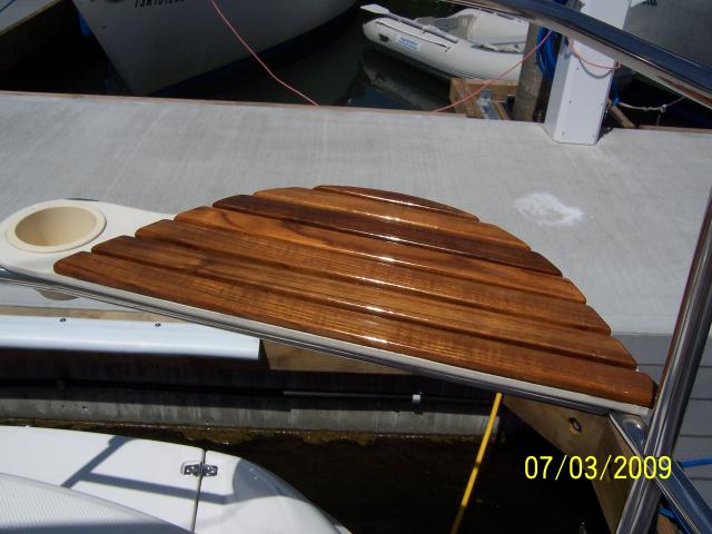

If you can guarantee that you can hermetically seal the wood, clear epoxy such as System Three will permanently seal the wood. This requires that any screw holes or other perforations be sealed with silicone or other sealant. The epoxy must also be coated with varnish for UV protection.
I have only a small amount of exterior teak but after five years, it still looks like wet varnish.
