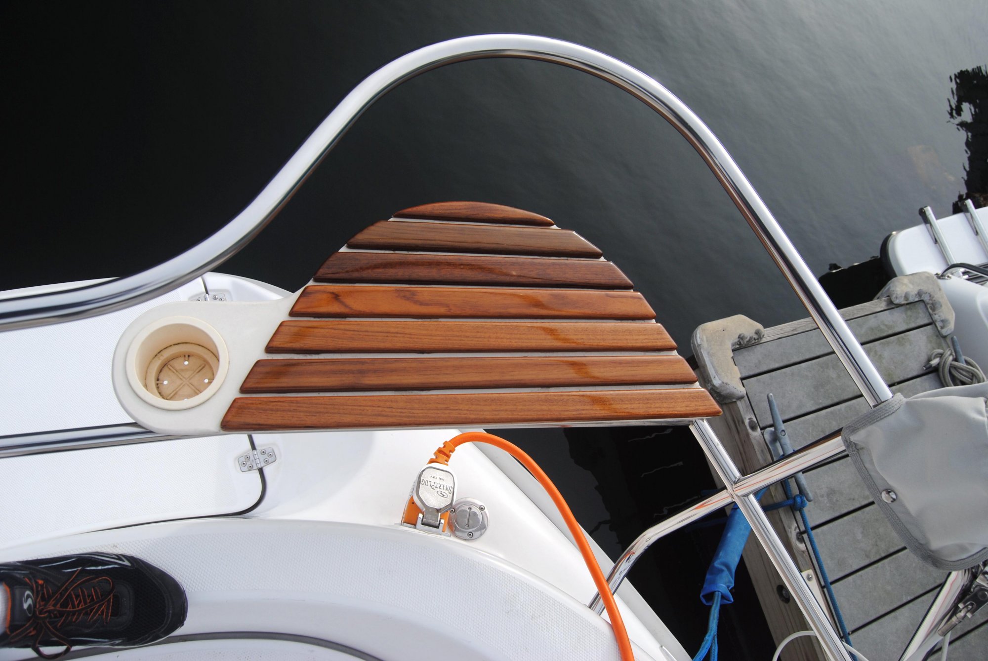

If I were so lucky as to have wooden hand rails as you do, I would take the opportunity to remove, scrupulously clean, apply 5 coats of clear epoxy and three coats of spar varnish so that they had a surface like this after 15 years of exposure :
