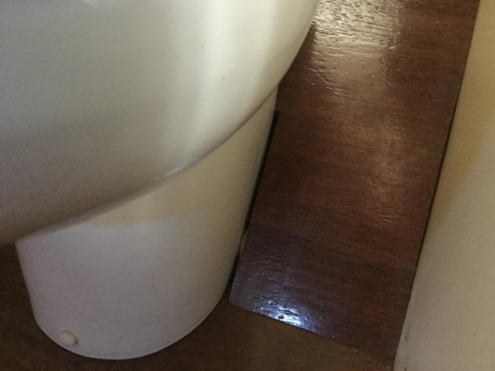

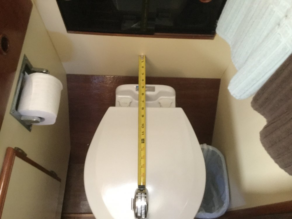

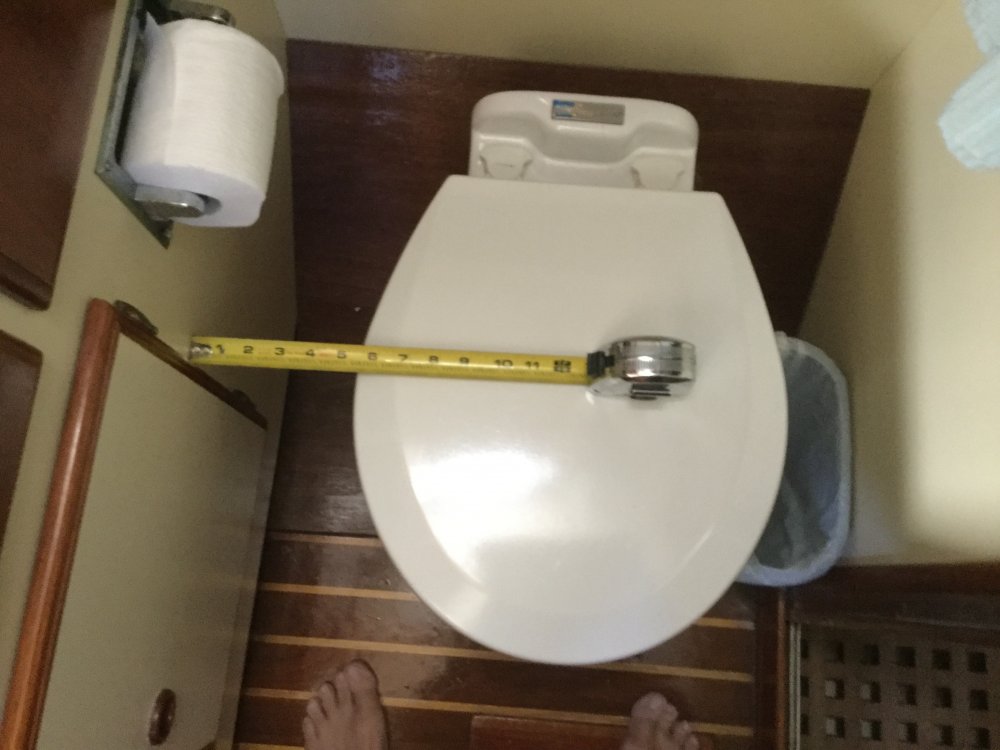

6291C326-F56D-4D20-A82B-B8AAB0D8BA27.jpeg AA2567EC-BB1B-43C2-B106-72B0E29479AA.jpeg 53ADECE3-DCF3-47A3-9402-6EDD2C9C36D3.jpeg
My clean installation shows all plumbing and wiring hidden behind the bowl. Once I remove the three screws to the floor bracket it can be slid forward 6-8 inches. I can then expose the plumbing which I try to exhaust as much fluids as possible over the vent loop. (Three feet of 1 1/2 holds quite a bit.). The seat is removed so the hose holder can be removed to get at the joker valves. I can’t get my head and an arm behind the bowl to loosen then realign hoses and clamps to those joker valves.
Like Apollo XIII using the tools and supplies on board, how do you fix it? No using specialty tools or plasma cutters.
