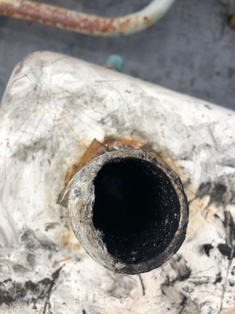

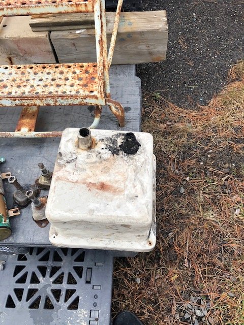

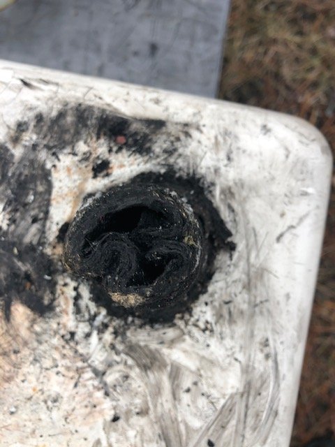

Three pics.. Today I had my Hurth transmission pulled out for either a rebuild or replacement. During the summer, I had noted soot water running across the top of the water muffler. Figured it was OEM and might need replacement. Ordered one from Catalina Direct in August ( still waiting for it). With the tranny out of the way, it seemed a good opportunity to remove the muffler. It might also be noted that anytime the RMPs were advanced beyond 2500 the engine would begin to overheat. The pics speak for themselves. At some point before I acquired the boat the hose clamps were tightened down to the point that they collapsed the fiberglass tank nipple. This restriction surely is responsible for overheating at higher RPMs. OYE..
