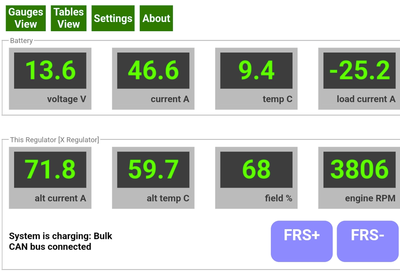

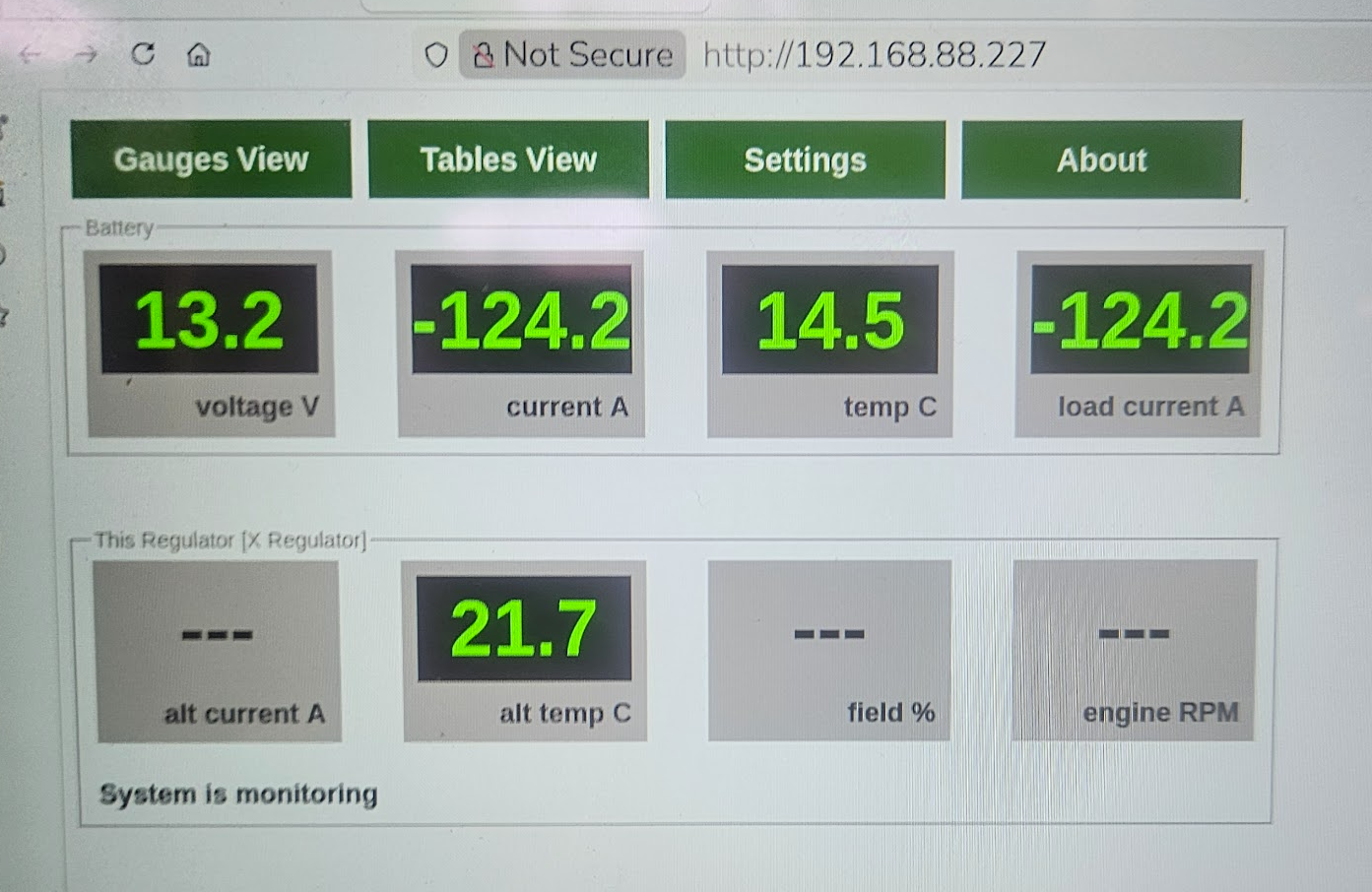

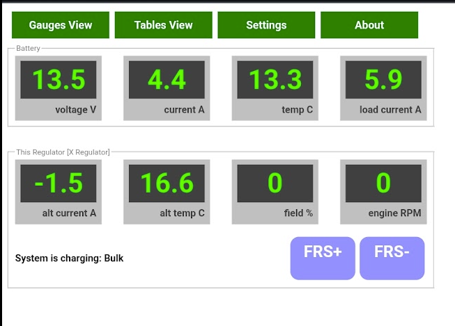

Bringing back an old thread ..... I recently installed 2 Electromaax Pro X regulators and worked on a 3rd installation. One was installed a balmar 100A and the other on a Delco 80A alternator.
Overall it's very very good product at a very competitive price. Support via email and phone was excellent, even with the owner chiming in to my support email enquiry within a few hrs ensuring I was being looked after.
First install took about 6 hrs, second about 2 hrs. The fact that remote support is available in case you have issues with the config is really great. The product has a lot of configuration options (and excellent engine load / battery charging management) options, thus the complex UI and large number of settings. Read the manual 2-3 times (both the quick install guide and the full manual) and you should be OK if you understand how alternators work and how batteries are charged. RPM input from the alternator is optional but opens up additional config options.
I can't explain why my alternator is producing less heat (20-30 deg C cooler) and provides about 30% more output than my old Balmar, and plays much nicer with my lithium battery (it has never forced a BMS kick off during charging, which happened from time to time with my Balmar regulator due to poor voltage regulation).
The ability to easily send the information to your instruments via NMEA 2000 (Pro X) avoids having to use the app while under way.
Lightyears beyond Balmar in terms of capability and far better value than WS500.
All the units we installed came with alternator temp sensor, alternator current shunt, battery current shunt and battery temp sensor.
