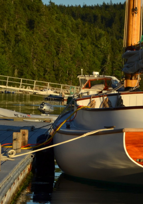

The image below is a prime example of where salesmanship, lack of real math, owner desires and reality failed to be in agreement.
This owner built a gorgeous brand new small wood day sailor (huge $$$ BTW). They wanted EP and EP should meet the desires of the day sailor, right?
In this case the actual use of the system, wind died on an outgoing tide, failed to meet the owners expectations based upon what they had been "sold"...
This photo is of the actual boat tied to an active "working dock" after being towed in in order to recharge the EP bank. It was there, utilizing dock space not intended for this, for 24 hours while recharging (see extension cords). Here in Maine we don't have many marinas and our docks are not intended for tying along side for longer than filling with water or getting fuel or ice. To spend 24 hours at a "working dock" is simply not being courteous to the dock owner or fellow boaters.. Sadly this owner had been sold an EP system that failed to perform to the marketing they were sold on. When I asked the owner about the possibility of using a larger charger and carrying a small Honda I got the evil death stare, as if I had just suggested the world was flat...
Please use real math, don't try to reinvent Ohm's law or Peukert and be realistic in your expectations..
