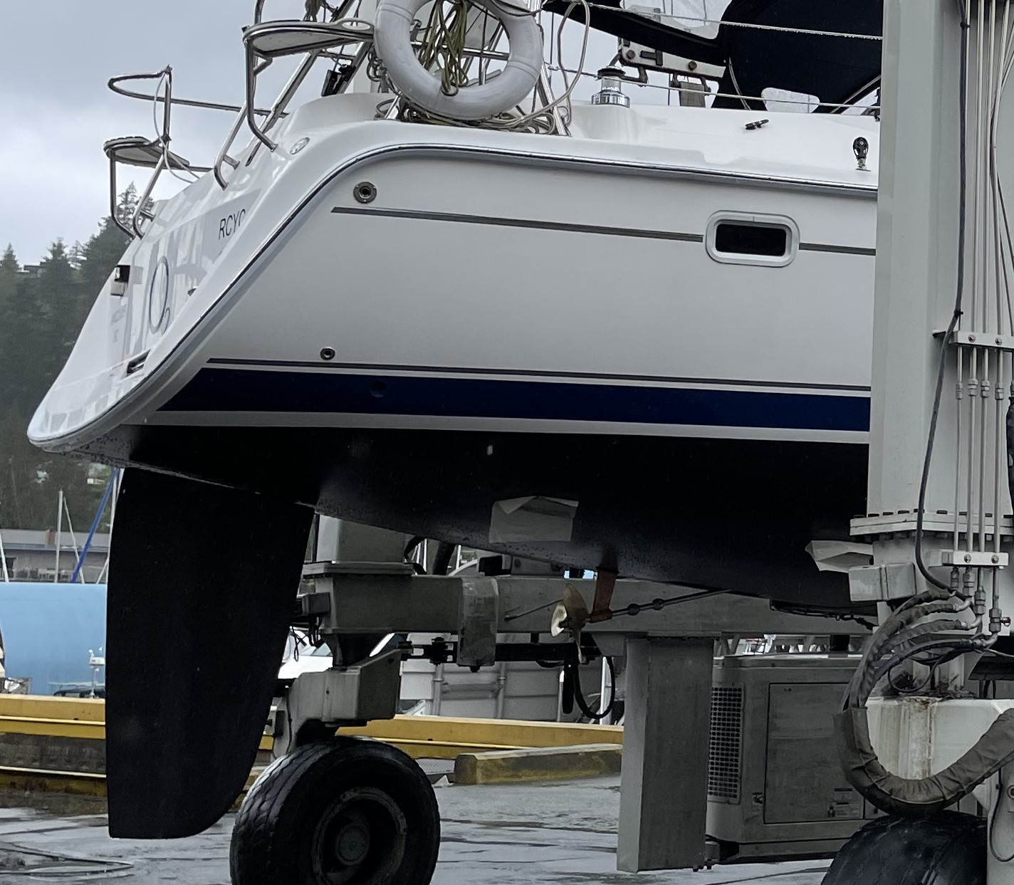

WbyN have been very good through the quotation process. I don't have the measurement from the blade to the hull and the boat is in the water. From the pictures WbyN said there "should" be enough clearance plus they have supplied this size of propeller for other H36 without any negative feedback. It looks like more than 2".

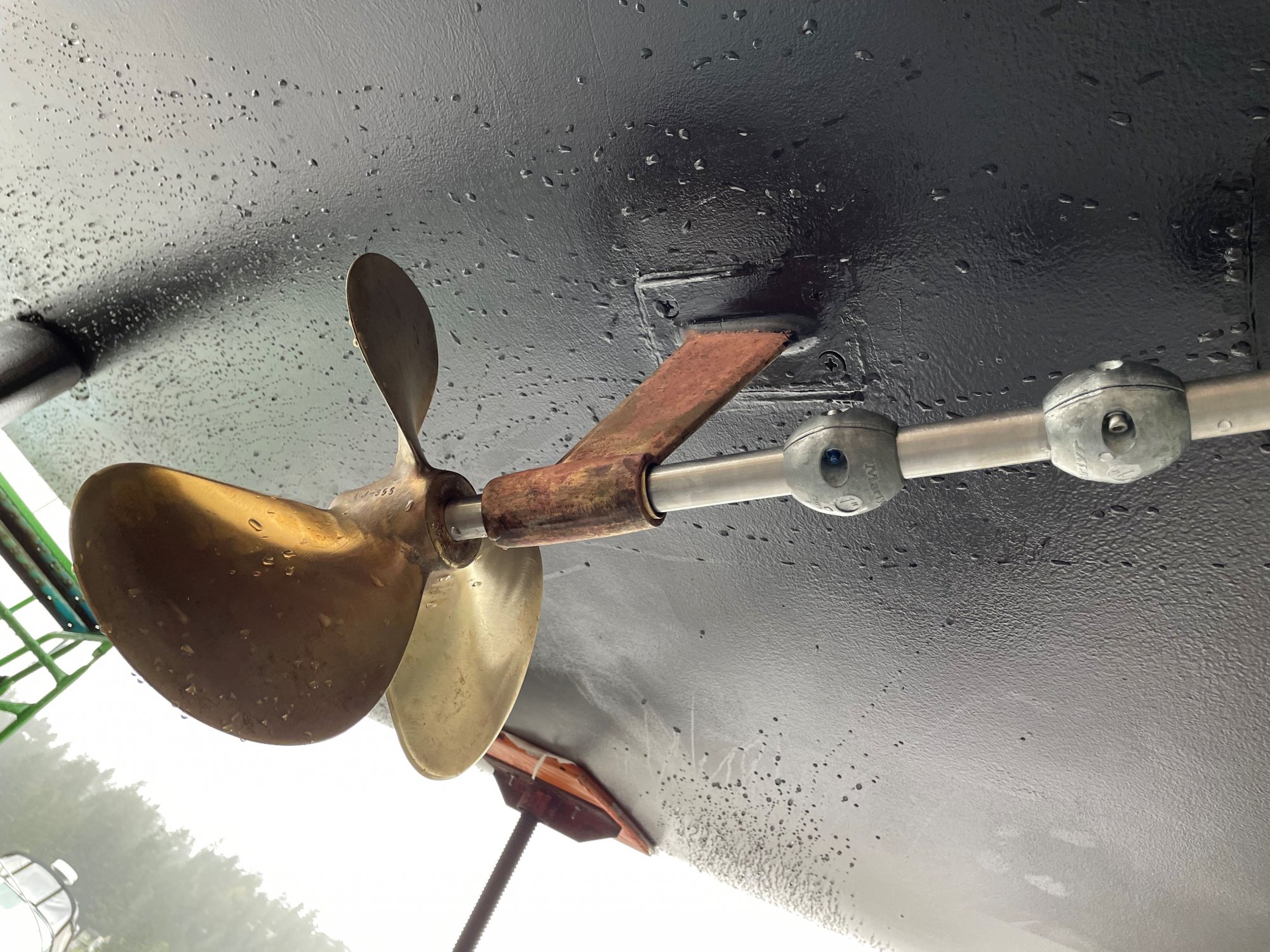

24,926
This is the prop I took off in 2018.
Bad design flaws that made this a bad Prop on my boat.
Here is what the Campbell Sailor looked like coming out of the box in 2018.
Here is the prop in 2023. Just out of the water, when I did the shaft replacement, the rebuild of my engine and transmission.
Looks good for being in the water for 5 years.
The design gives me more forward thrust without dragging the stern down or overloading the engine. Yields improved performance.
