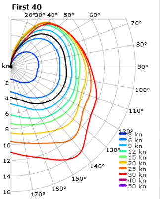

I've raced a First 40 and, with the right sails, they do sail very well in light air but really stretch their legs over about 10 to 12 knots.
If you really want to know how fast a boat sails, find the Polars for the boat, but they are usually only available for boats that are raced. This will tell you the expected "best" speed for the boat under different wind angles and speeds

D'arcy's advice provides a good yardstick. To understand PHRF ratings it is important to note that the figures theoretically represent differences in seconds per mile of boats sailing a triangular race course. On a 3-mile triangular (windward, reach,reach) course, the Beneteau First 40 in D'arcy's example would be expected to finish about three minutes (57seconds difference, X 3= 171 seconds) ahead of the Oceanis 46.1. If they did, they'd win the race. If they didn't, and the Oceanis finished just two and a half minutes (150 seconds) after them, the Oceanis would win. Beneteau will provide polars for their boats if you ask them. Their brochures talk a lot about sporty performance. "Test sail" articles describe handling and aesthetics without saying much that the builders haven't already said. PHRF ratings tell you more what you can actually expect.

There is a cool bit of software called Sail Grib. Runs on Android. The free version has polars for many many boats. You can plan a trip on a map, then download the weather files (gRIBs) then input the boat type and it will suggest a routing and give a time estimate. Try it with all the boats you are interested in and see what kind of difference it makes. The author is French (i think) so it biases somewhat to French boats but that is what you are looking at anyway.
