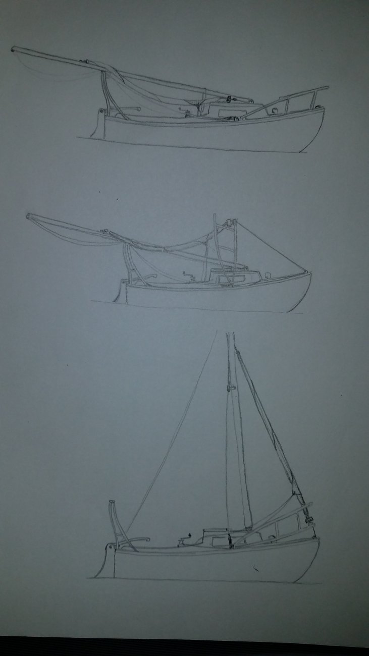

My idea is to use a hinged bow pulpit as the gin pole. Leave the forestay connected to the pulpit and pin the pulpit in place. Use a winch to pull the pulpit down into place or, in my case, I think it could just be done by hand. A transom arch would help a lot. I would run the pulpit back to the shroud chainplates and that way, the shrouds could be attached to the pulpit also. It would look a little more like a powerboat's speedrail, but I think the look would be ok. You should even be able to have life lines connected to the pulpit.
Step 1. Move mast from trailer position to tabernacle.
Step 2. Unpin pulpit from bow chainplate.
Step 3. Lift pulpit up to connect forestay.
Step 4. Crank pulpit back down into position while mast raises. Make sure all turnbuckles and stays remain clear, unhindered, and untangled.
Step 5. Pin pulpit back to bow chainplate.
-Will (Dragonfly)

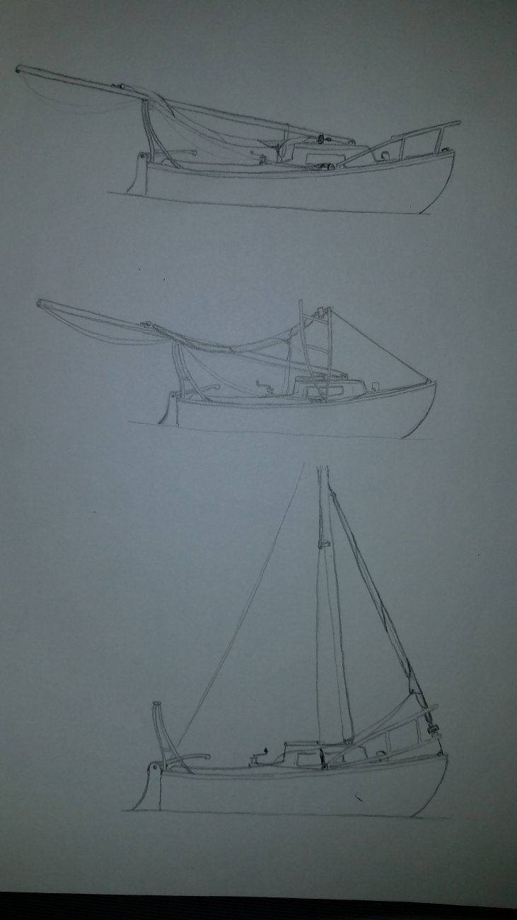

-Will (Dragonfly)
That looks pretty secure alright. Just too much for me to want to carry on the boat.
I just use my mainsheet and back stay adjuster (2 sets of 4 part tackle) as baby stays. Even with the boat rocking I haven't had my mast go off center except the time I forgot to tighten one of the baby stay tackles. So all I have to carry on the boat is my 6 ft gin pole that has its own brake winch.
ymmv
Interesting idea!
I have a gin pole that attaches to the (otherwise unused) holes at the front of my mast deck plate. The gin pole is just long enough that it reaches the deck fitting for the forestay. The top clevis of the forestay turnbuckle has an extra long clevis pin that fits into a fork-like fitting on the top of the gin pole. To raise the mast (once it's pinned to the deck fitting) I hook the forestay to the top of the gin pole and then hoist it up with a block and tackle. When the mast is fully up, the forestay turnbuckle is perfectly positioned over the deck fitting and I just pop in a pin and the mast is secure. The block and tackle stays attached to the gin pole, which then tips up and lashes to the front of the mast.
For stability, I have baby stays that attach about six feet up from the foot of the mast. The baby stays run to pivot points on a tube that runs between two of the lifeline stanchions (on each side of the deck), so that they are in line with the pivot point of the mast. That way the baby stays stay tight as the mast goes up and down. The baby stays keep the mast from swinging as the boat rolls or lurches, and I've used this system up to about sea state 3 without any problems. I would probably avoid using it in conditions rougher than that.
