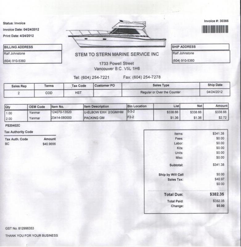

................... kloudie, that little 316 SS beauty is actually cheaper than the last cast iron elbow I bought for $382.35 THREE YEARS AGO :eek: :eek: :eek:. Even with the exorbitant shipping and using Canadian pesos, it's still going to be much cheaper.
Don't know why I haven't run across these SS units before but my present CI one is due for replacement next year and it's going to be one of these.
Granted that the mixing elbow's need for replacement is a result of the internal coking where the hot exhaust meets the cold sea water, I'm curious to see if the lack of corrosion (on the 316) will release the built-up carbon any easier. Even if it makes it more adherent, the 316 SS elbows are still much cheaper than the CI ones for me.
