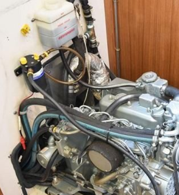

Hi All.. Does anyone know what the metallic wrap is around the exhaust riser? I peeled ours off to inspect the riser. I've been able to get the fiberglass wrap back on but i'm not sure what this metallic foil actually is. everything i find online says not for use on headers or exhaust pipes..

It is not the exhaust repair tape you see in auto parts stores. It is a metal based tape sometimes used to cover holes, etc. I have seen it used to cover bullet holes in aircraft. It might be available through hardware outlets, but I'm pretty sure Catalina Direct can supply it. As you noted, it is wrapped around the fiberglass wrapping, not directly on the riser.

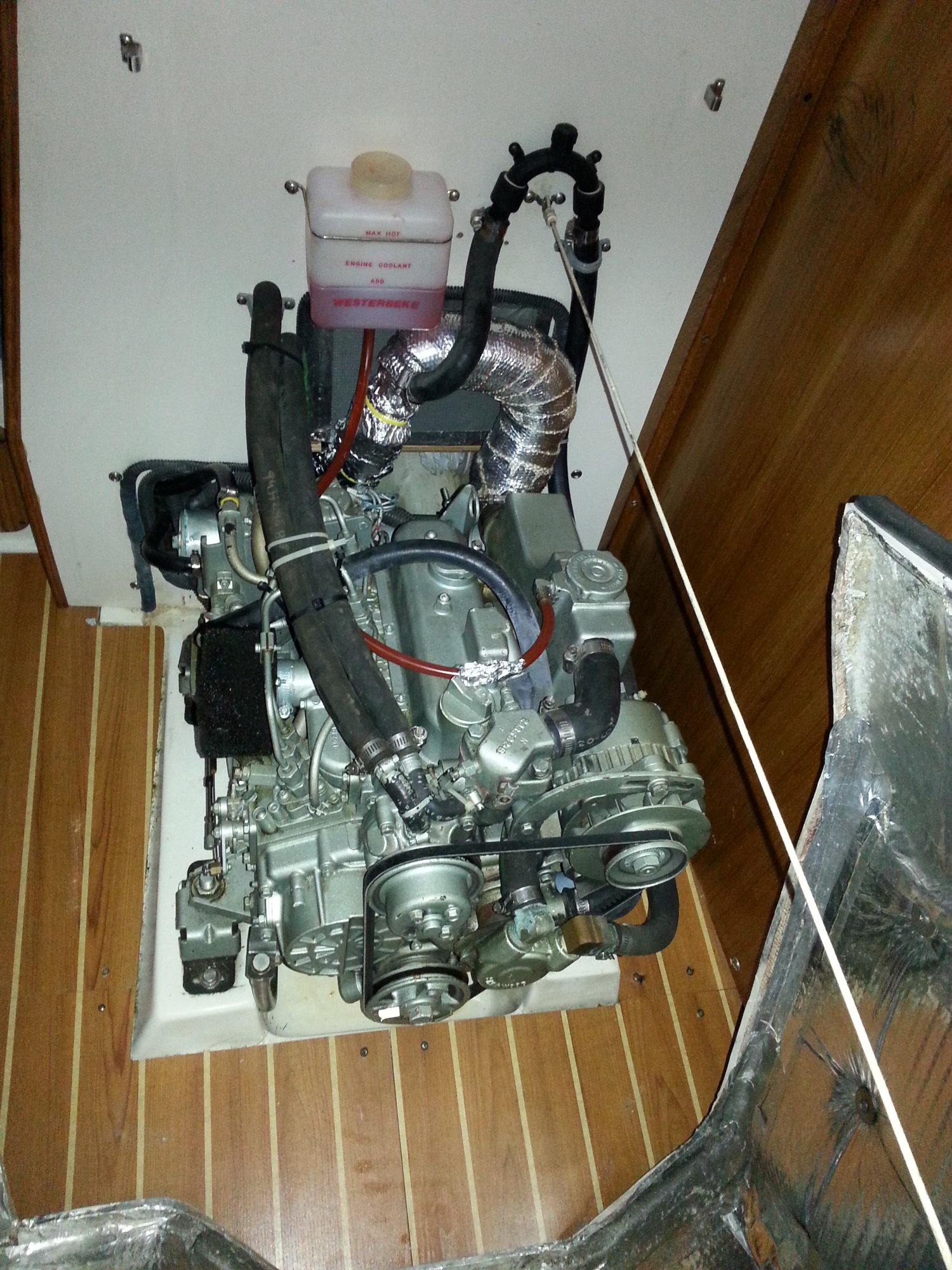

Looks more like this... a foil, rather than a silver backed fiberglass tape.

Yes, it is a foil, wrapped around the fiberglass insulation. The first time I re-wrapped my riser, Catalina Direct sent me a kit with the fiberglass and metal foil. This was in response to the issues the C310 had with the bulkhead getting burned from the hot exhaust.

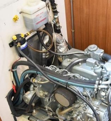

essentially this?

Aluminum foil tape. In the airplane industry, known as "speed tape".
