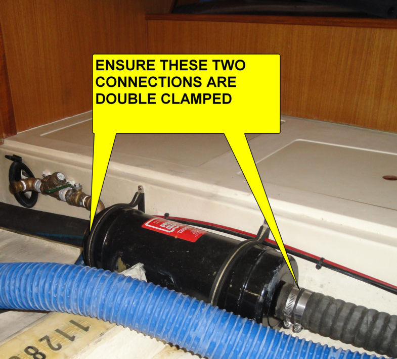

muffler seam to leak water into bilge, where should I look to find where leak is coming from.
Jan 4, 2006
7,862
At the risk of appearing to be a smartass, look at the water muffler and the two hose attachments.
I trust yours is the same as mine:
Next, look at the body but I doubt it's leaking as it's FG and has a long life expectancy.
