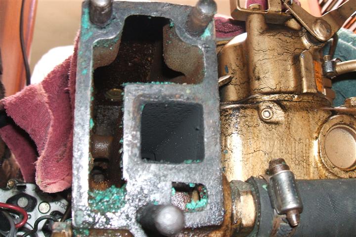

Here's ours in 2008, 1986 boat. Pretty clean even before prepping for the new riser and "green" Universal gasket. We'd just taken the exhaust riser off.
M25 engine, around 2,000 engine hours. On our diesels, it is NOT the manifold, it is the riser.
