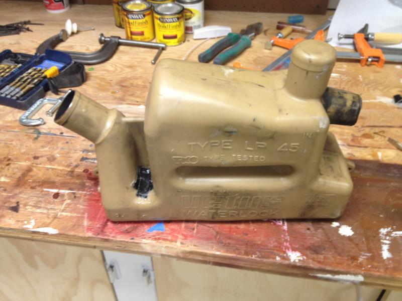

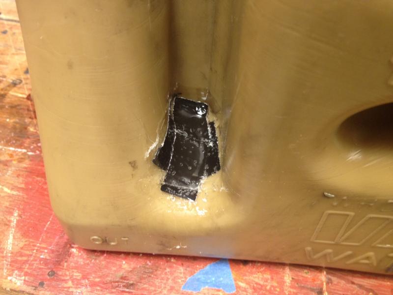

I finally found water spraying from the VETUS water lift tank when the engine was running. I found a cut in the plastic, as if somebody had driven a flathead screw driver into the tank. I think water was actually pressurized in the tank (it is at a low point in the exhaust) when sailing speed was high enough and water could leak from the tank even when not under power. The cut was in the oddest location, and I pulled the tank out to put together a Rube Goldberg style patch. I used this sealant/adhesive that I found at Home Depot and Gorilla Tape (my favorite repair product!). It actually seems to have worked but I neglected to notice another gash in the plastic which you can see in the photograph just above the letter "E". I simply can't figure out how these things are occcuring!
I installed the tank yesterday afternoon and to my chagrin I saw the water spraying from a new location. This happens to be underneath a mounting strap so I have to pull this whole thing apart once again to make my patch.
