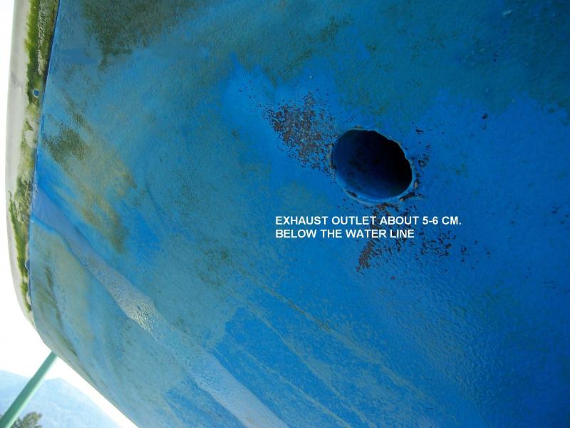

The exhaust outlet on my Hunter 280 is underwater, and it does not have a flapper.
