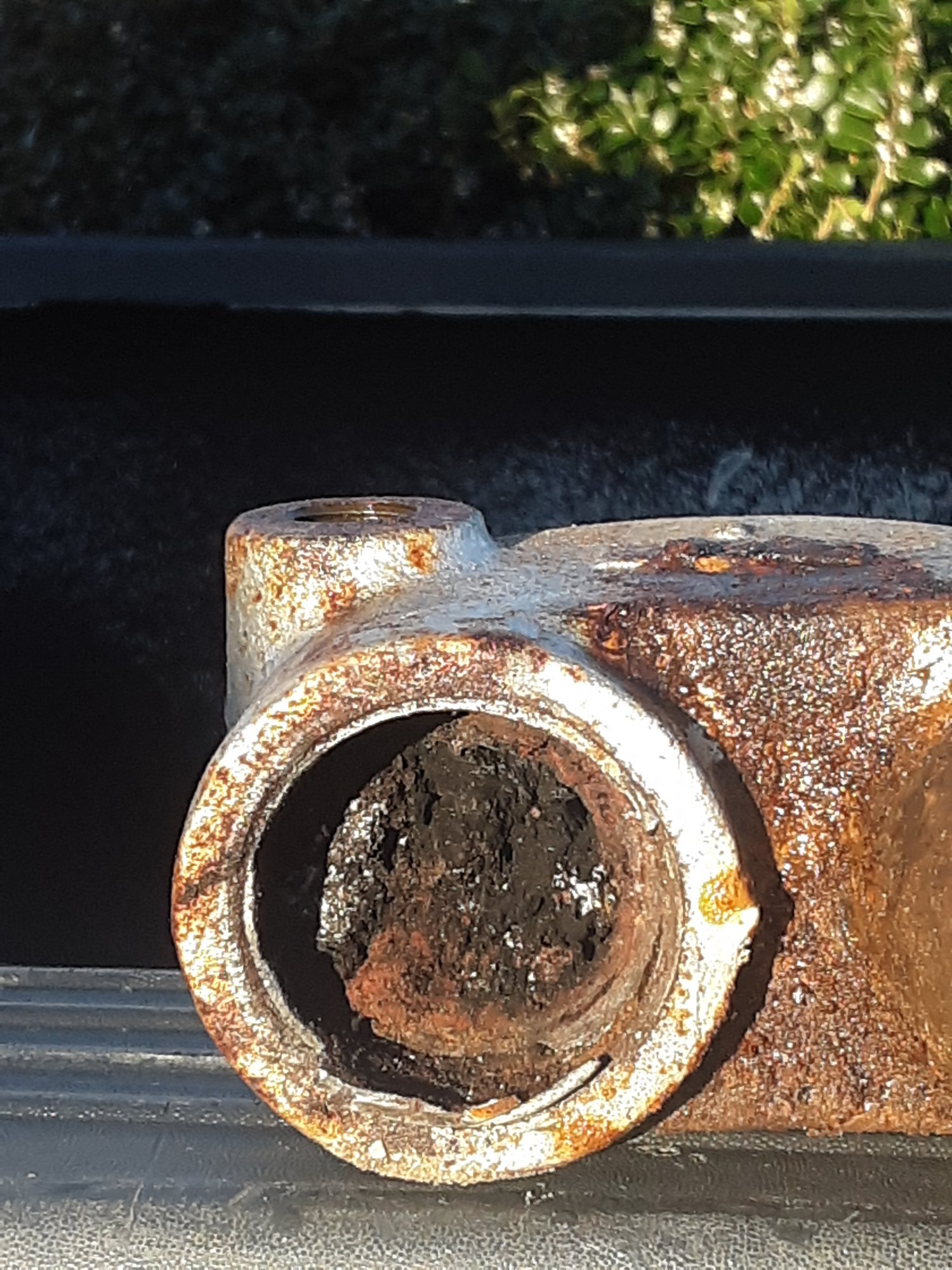

So the other day, exhaust filled my cabin. It appears the the exhaust elbow has rusted. Has anybody had this happen to them?

Looks like the joint cracked off just above the exhaust outlet.. The thing has a left handed thread on one end and a right handed thread on the other (I don't remember which is which) so it is not common. The Yanmar part number is 104214-13580, and costs about $40. Best to get an outlet gasket (part # 128370-13201about$8) and pull the outlet to get at the part that is stuck in the threads.. Good Luck

If it broke at the nipple then chances are the U-elbow is probably towards the end of its life. Get a new one, a nipple and a gasket and as per Kloudie's suggestion remove the outlet to make it easier for yourself. You can use Yanmar or get a stainless steel one from HDI Marine. HDI sells it complete with the nipple.

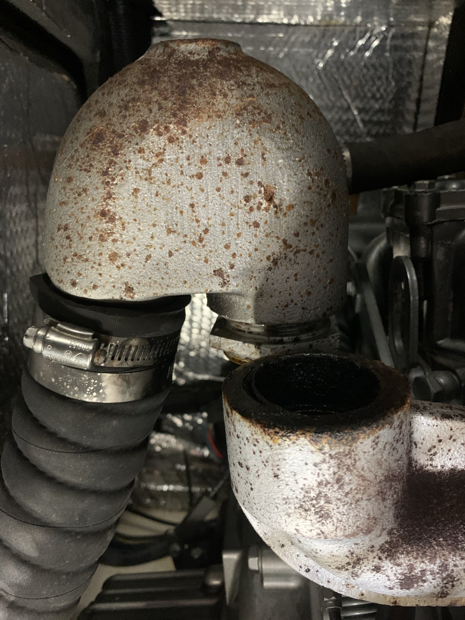

Yes. And it always rusts out from the inside. It made a disgusting mess in my engine compartment from a 1/4 inch hole. Four years later I am still finding black spots that need cleaning. I replaced the entire mixing elbow. It was hard but straightforward work. Once I pulled out the old one it was completely rusted. I would definitely replace it.

When I had to do this years ago, I used fiberglass elbows. So far, so good. No rust.
