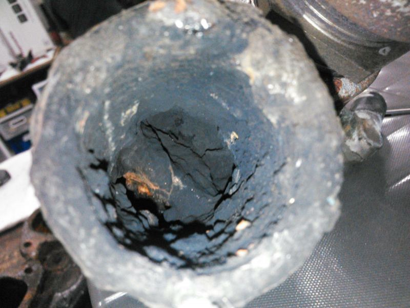

I would like to inspect my exhaust elbow for carbon build up and was wondering if there was an easy way such as removing the output hose or if one must remove the whole unit. The hose looks like it has some sealer on it when it was installed and maybe tough to remove and the mounting bracket probably needs a gasket to be re-installed.
Any comments?
10,202
With a strong light, a mirror and some good eyes you can pull the hose off and look up inside with the mirror and light. You are looking for a carbon build-up that would close the upper part of the exhaust passage. When they really get bad, the hole can be closed by the carbon to 3/4" or less.. It amazed me that the engine ran as well as it did with the hole closed that much.. it did overheat at high power settings..While you are there, pull the little hose at the elbow too and check it to make sure it is completely clear at the fitting.

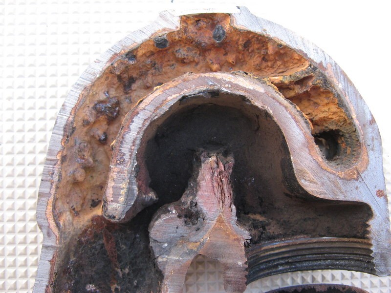

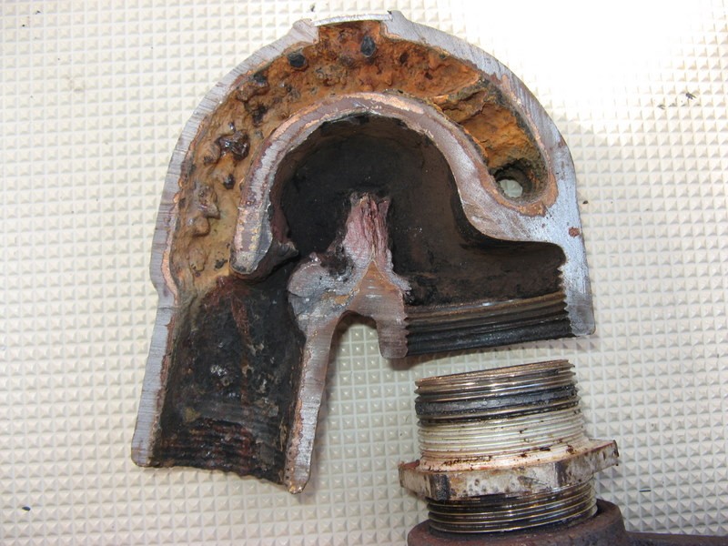

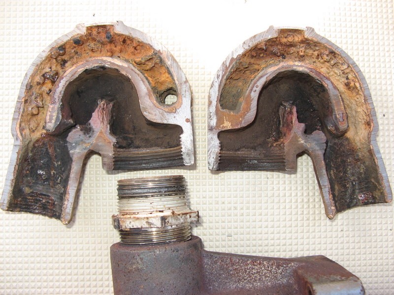

Here are some pics of a cut-off mixing elbow I found a while back on the internet. Don't know who the author is so I can't pay credit but hopefully it will help you visualize if yours needs to be cleaned out or changed.
Jim L
Jun 13, 2012
49
Hunter 28.5 Kemah, Texas
Now I would like to see a section view of a new mixing elbow. That was an informative visual.

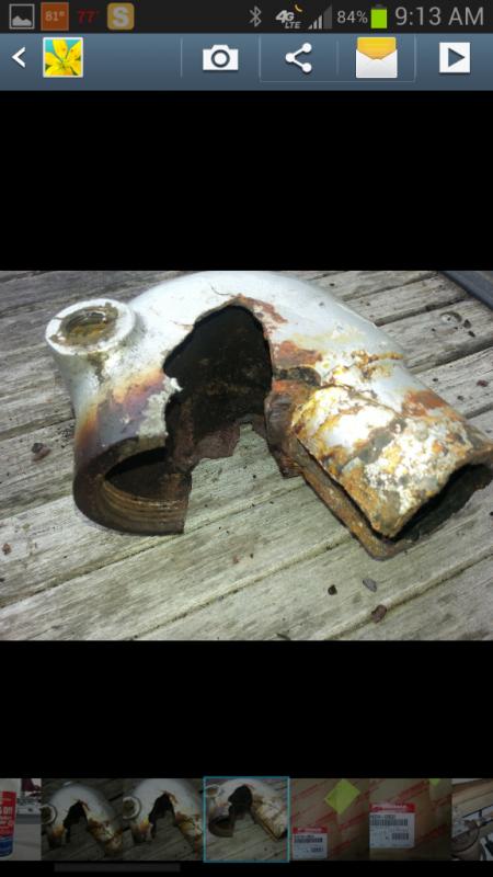

If it is cool to the touch on the exhaust side while it's running.. don't worry about it. I check my nearly every time we use the motor. The last time I checked it was a little hot .so I checked the water pump impeller. All is good there. So I took off manifold. Well as everything was rusted together on the threads. So I gotta ball peen hammer and hit the elbow one time and it just shattered into four pieces perfect.... I was thrilled and worried at the same time. Threaded the new one right and job done.
Jim L

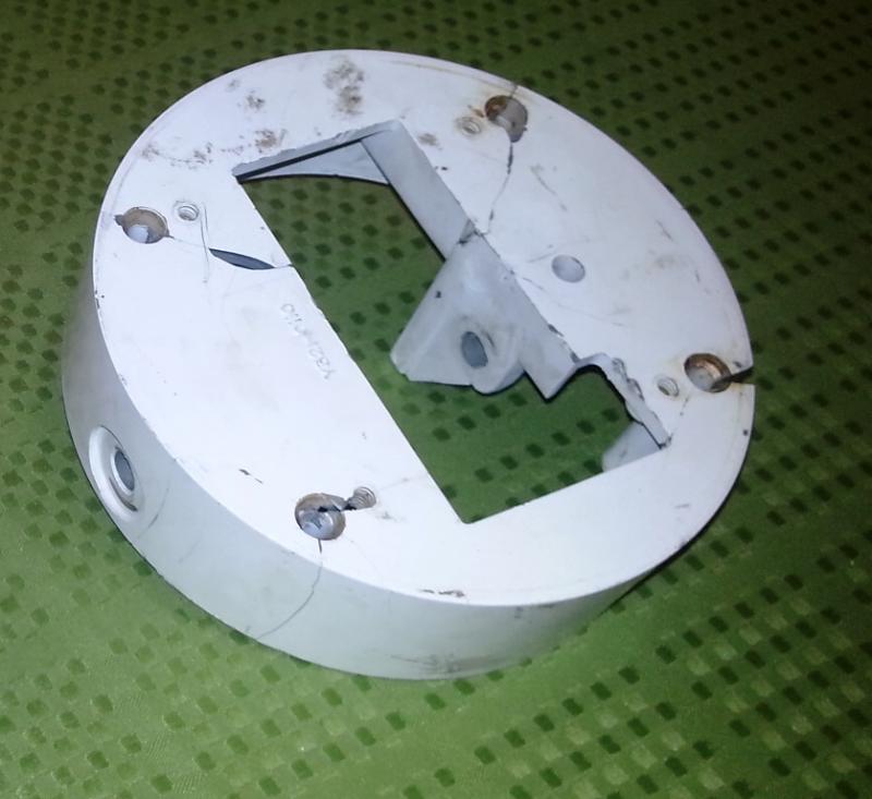

:DFinally got out this weekend. WOW What a difference in her performance. Really gets up and moves now with power to spare. Tach still only maxes out at 3,000 but at that max rpm I get to 7.5 knots in calm water. still need to figure how to get the throttle from inching back down on its own while motoring.
1,699
Hunter 34 Alameda CA
If you have the Yacht Specialties control head (the part that the throttle and shifter levers are mounted to), there is an adjustment screw to increase friction on the throttle. Take the compass off and look down inside. There is a hole that is right above the shaft for the throttle lever. Inside is a plastic tipped screw. You can tweak it a little with a small screwdriver that will reduce the slippage. Don't turn it too tight or you won't be able to move the lever or worse it will crack the plastic control head.
There may also be a metal clip around the cable down in the engine area that has a bolt on it. Tightening the bolt will put the squeeze on the cable by crushing the sheathing.
