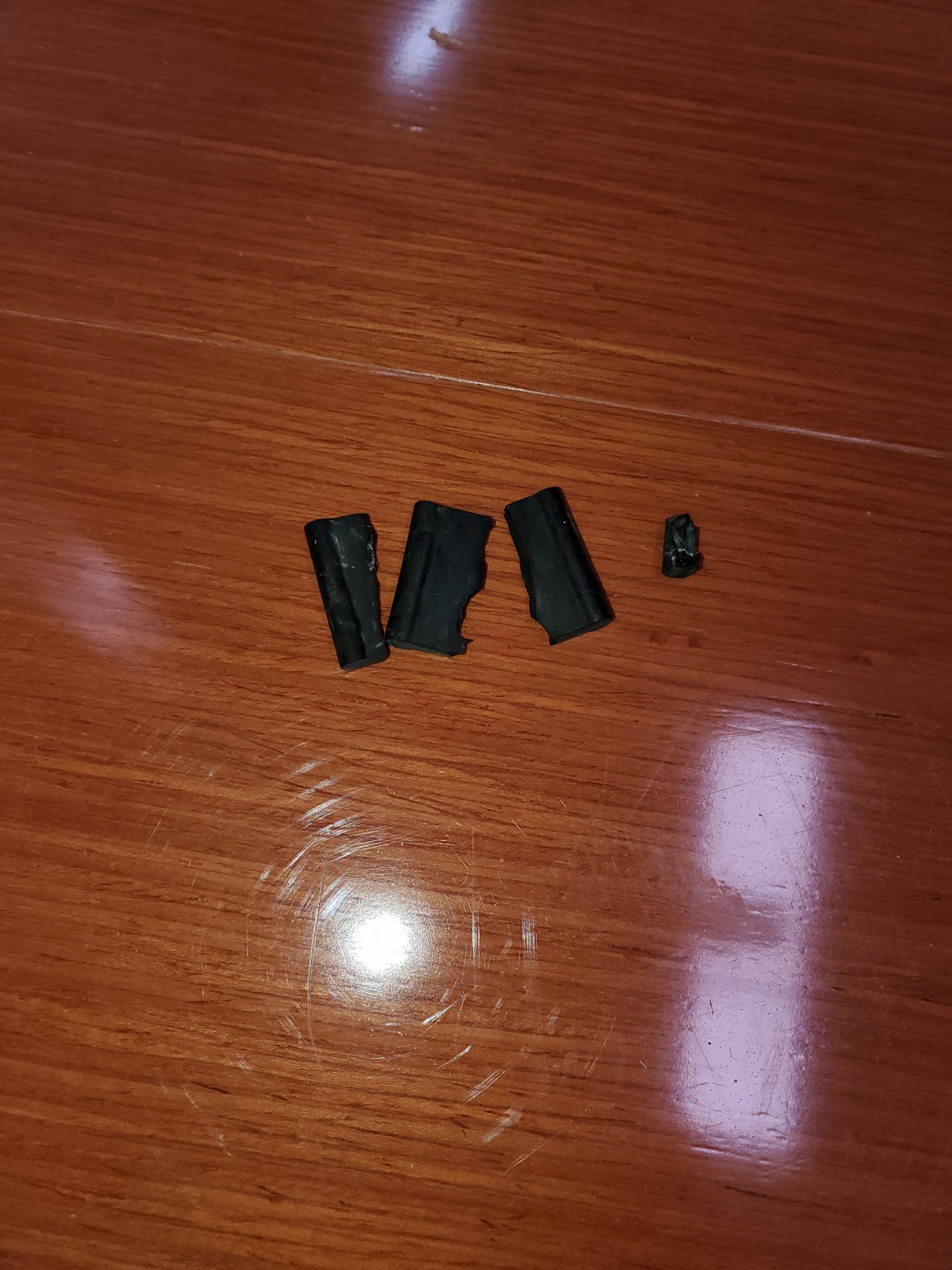

The impeller is easy to change, did it 6 months ago. I still need to find/remove one missing vane, probably more now. I have two spare impellers, but not for long.
There are 2 things that you said here that grabbed my attention.
First, if you have a missing vane from a previous failure, you need to find the piece(s). The broken bits will cause a clog that can be harder to fix. I wouldn't run the engine until you know there are no obstructions. Perhaps it even has something to do with feeding water to the dripless system. On that note, I am unfamiliar with that system, but I suspect that you might simply have had trapped air in the bellows and if you "burp" it you should be all right. I'm more familiar with PSS, though, where the water comes in directly from the shaft tube.

About the missing impeller vane. I changed the impeller about 6 months after purchasing the boat and found 1 missing vane. It hadn't been a problem up to that point. I found a suggestion on this forum to use dockside water to push the vane back down to the pump with the pump cover removed and an old sock stretched over the pump. That sounded a lot simpler than removing the alternator and the heat exchange cover. But the water has been off at the dock and will be off several more weeks. I was simply putting it off and I may pay a price for it.

Found a few broken vanes in the heat exchanger today. The impeller looked perfect, replaced it anyway. The impeller from 6 months was missing 1 vane.
