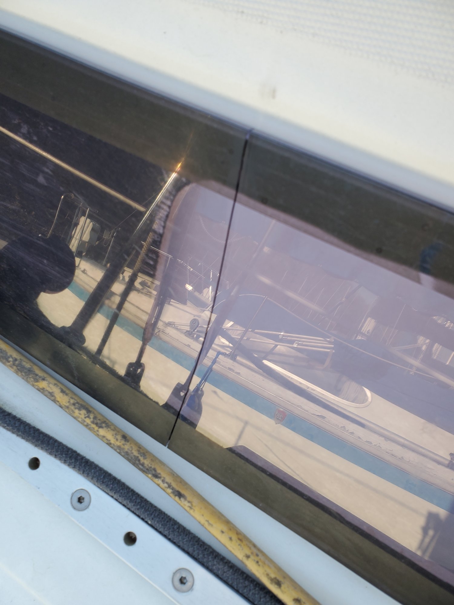

Back at the dock I found the window on the port side has a large crack in it. I'm sure that will be expensive. For now it has a piece of tape on it. I'm not looking forward to fixing this. Suggestions?

The cracked port light is only modestly expensive depending on where you get the replacement acrylic. It can be a messy job, but many many sailors have replaced them. See the video below.

I'm just gonna use some nice wide black tape on the window, at lease for a while.
I've found that Gorilla tape works well for a solid season does leave a nasty residue... Pretty water proof on top of it....
dj
I may give that a try. Thanks
I'm also thinking about cutting the other window in about the same spot. I would rather pick the location than just leave it to chance. Seems cracking of long acrylic windows is common or maybe they the adhesive loose, I can't remember exactly but they are problematic due to differing expansion rates.

Gorilla tape makes a clear tape that might work.
