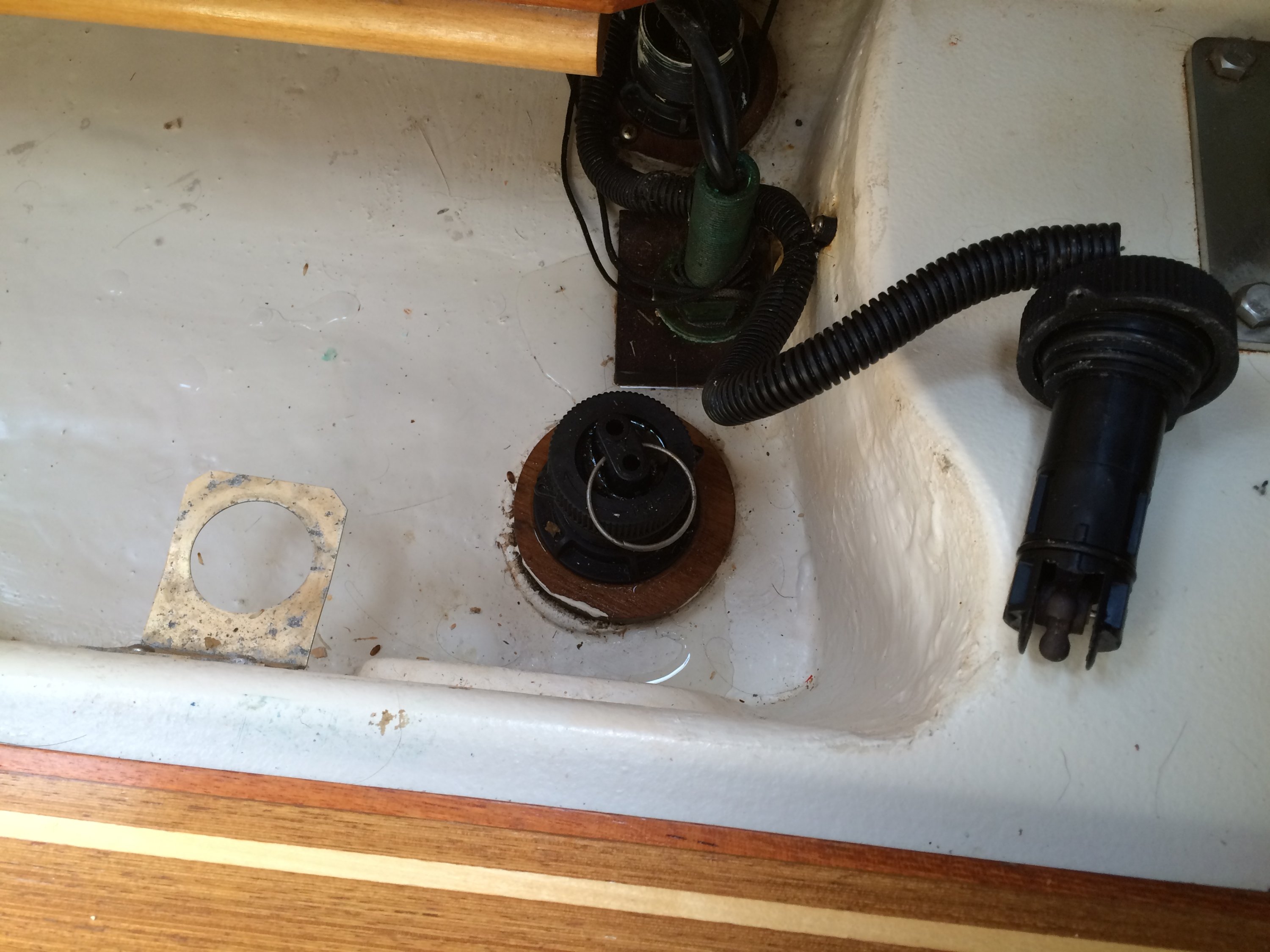

5) My last question is with attached photo. What are these wires in my rear bilge? It appears when I unscrew cap with no wires water comes in bilge. It appears there is an option to replace cap with no wires with cap (with wires). Notice cap (on right side) laying next to cap (with no wires). Notice holder on left where cap with wires held in place when not used. Cap with wires also has a impeller or propeller that must be propelled by water when screwed in.

That is a knot meter. The cap is used to close the thruhull when it is removed for cleaning (as it is now).

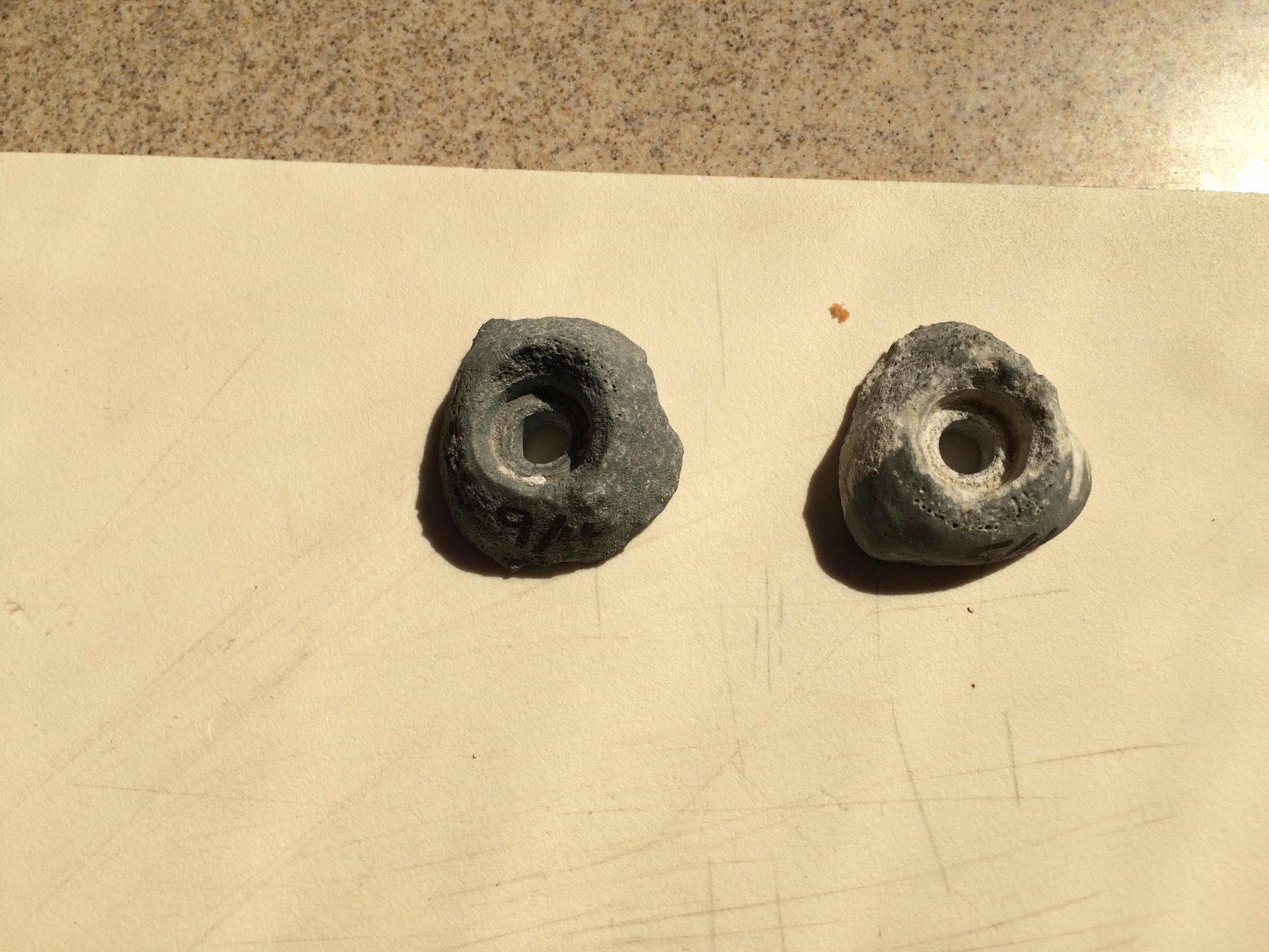

Attached is two prop zincs replaced. One in May and one in September. They forget to leave the other zincs on my boat swim out for the other months. I believe these are pretty much deteriorated.

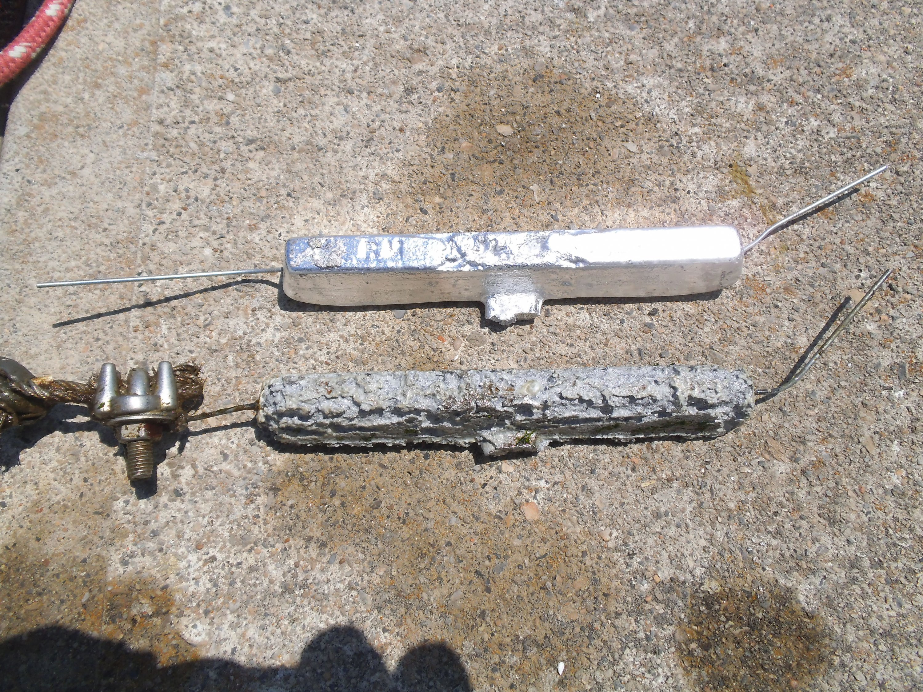

A stop-gap option, particularly since you don't leave the berth much is to hang a "fish" zinc.
On my boat, I have a shaft zinc, but I also have a "fish" zinc hanging over the side. It does sacrifice, so that's evidence it is helping. Between the two, the shaft zinc depletion rate is definitely reduced. If I didn't ever sail, I might even forgo maintaining a shaft zinc. But on the other hand, props are expensive, so its not worth saving a few zinc $'s in the exchange.
To ensure a good contact between the fish zinc and the shaft, I installed a shaft brush like this: http://shop.sailboatowners.com/prod.php?5673 to which the hanging fish is connected to. And for good measure, I also have run a "pig tail" from the fish lead to the engine block.
As to the fish zinc, the sailboat marketed ones are expensive. So I have a supply of these $3.60 zincs which are marketed to crab/lobster fishermen to protect their pots: https://rotometals.com/1-5-lb-tie-on-crab-pot-zinc-anodes/. To use these you will have to design your own connection between the crab zinc and the wire leading to the shaft brush and engine block. But if you design right, its a simple matter of pulling up the fish zinc every few weeks and if it is pitted/sacrificed, fit on a new one.

I have been told by boat owners in virtually every one of the dozens of marinas I have worked in over the last 22 years that their marina is "hot." Usually this is not the case and is the result of the boat owner simply being in denial about the state of his own electrical system. Rapid anode depletion is almost always the result of an electrical issue aboard the boat in question. Cudos to you for acknowledging that possibility.
The anode loss you appear to be experiencing is extreme. I would recommend you do two things:
1.- Have a marine electrician go through your electrical system to suss out the problem. If he can't find one aboard, have him check the shorepower system and for any stray current in the water. If there is an issue with either of these last two items, request that the marina alleviate the issue.
2.- Require the dive service to leave all anode remnants on the dock each and every time they replace one. It is a little suspicious that they have "forgotten" to leave the majority of the anodes they are replacing, especially since they are replacing them so frequently. They should be concerned with providing you with evidence of the problem. If they seem to be unable to do this, find another dive service.

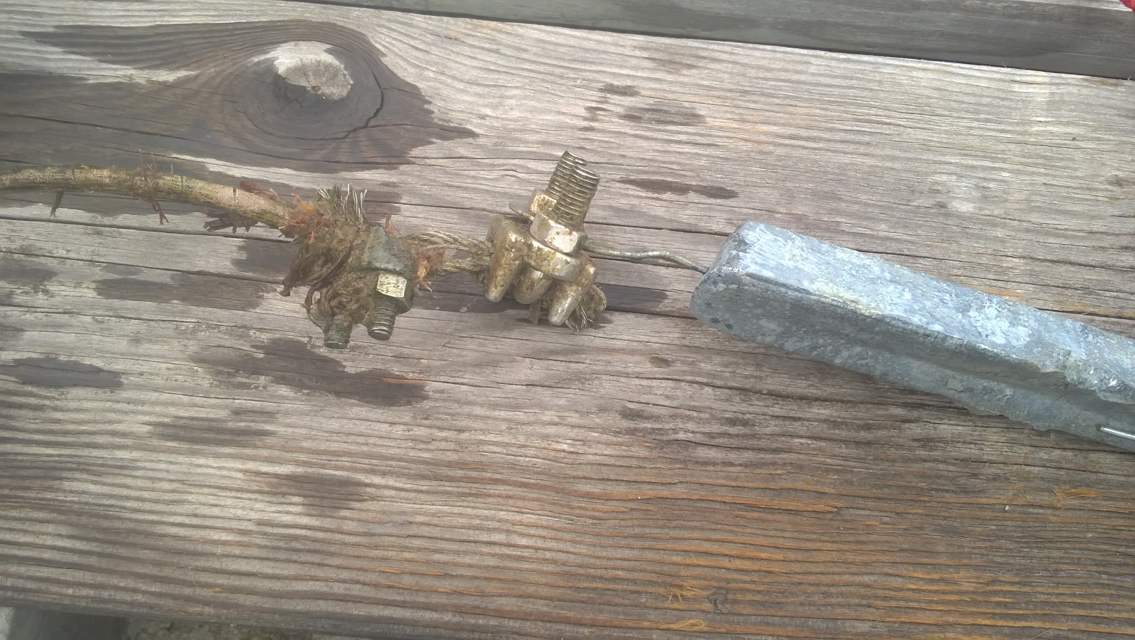

Ron
Ron:
Being at my boat yesterday, I took the attached picture of how I have connected the hanging zinc to the SS wire (salvaged from an old lifeline!) that leads up to my boat. The same clamps and wire have been in the water now for 3-4 years.
Inside my cockpit, I have installed a connector plug, so when I go out sailing, the hanging zinc wire can be easily detached from the further "interior" wiring for the run to my engine block and shaft brush. I tie the hanging zinc to a small line on the dock so I can quickly re-attach when I return.
As to more details, although I am comfortable that my hanging zinc bonded to both the engine block and the shaft brush assists with my protection*, I am not expert enough to confidently commit to any specific details.
Lots of info is available on the net: Search for Hanging Zinc Anode. And Marine Shaft Brush.
As mentioned my opening post. A hanging anode is something that is easily added to assist, but not solve your problem. So certainly follow-up on the other suggestions.
* For instance, just last week, I engaged a diving service to clean/inspect my bottom and check (and replace if needed) the shaft zinc. At the last service, about 4 months ago, the diver reported that the already 6 month in-service shaft zinc was still fine until the next service. But at last week's cleaning, the zinc was gone. Fallen off at some point. So I had the comfort knowing that the hanging zinc at some point assisted assuming the protection duty. Also attached is a picture of a new anode vs one that had been in the water for I think about 6 months. The difference shows the hanging zincs are sacrificing. At the time of the photo, I was using Aluminum Alloy anodes. I have since gone back to zinc.

It was suggested that your diver may be replacing too often. While it appears you may have a problem, I would not personally replace a zinc in as good a condition as your picture shows. Fstbttms can probably advise more on this. Chief
Feb 26, 2011
1,440
Achilles SD-130 Alameda, CA
The pic does not adequately show the state of depletion of the anodes, IMHO. Tough to make a call based on that.
