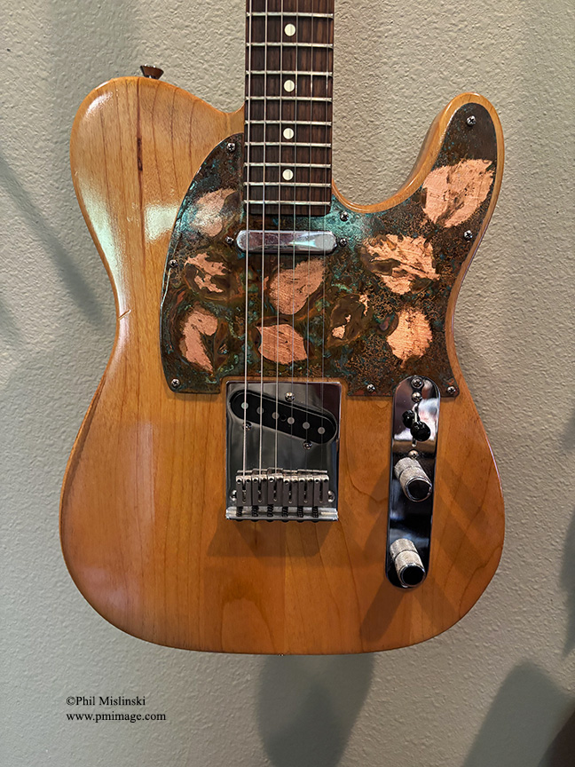

I won't be taking my old Telecaster on my sailboat as that's the place for my Taylor GS Mini, but I did make a new sailing inspired pick guard for the Tele recently. Copper sheet, ammonia, salt, hibiscus leaves, and six hours of "bake" time in a sealed tupperware.

Is the copper then covered in a surface or just etched.
Here's the process:
1. Use original pick guard to make a template out of plastic, plexiglass or similar
2. Use the template to cut out the shape using a router
3. Use the original pick guard to drill the mounting holes in the copper pick guard
4. Sand the copper with 220 grit then clean with acetone - always wear gloves when sanding and cleaning to avoid getting skin oils on the copper
5. Place the copper on some small wood blocks inside a large enough tupperware container
6. Press whatever you want to use for a semi masking material - I used hibiscus leaves. My brother used onion slices
7. Put ~1 tbsp of salt and ~4 ounces of ammonia in a spray bottle that can spray a fine mist. Mix by shaking.
8. Spray a fine mist of ammonia / salt on the copper. Try to avoid pooling - you can dab the pools gently with paper towel to remove them
9. Install the tupperware cover and let it sit for ~6 hours
10. Remove the copper pick guard and let it dry in air for ~6 hours
11. Gently rinse in a bath of warm water
12. Let the pick guard fully air dry
13. Spray 4 to 6 coats of clear, lacquer spray paint or brush with clear nail polish. I used Rust-Oleum clear lacquer spray finish and did 5 coats.

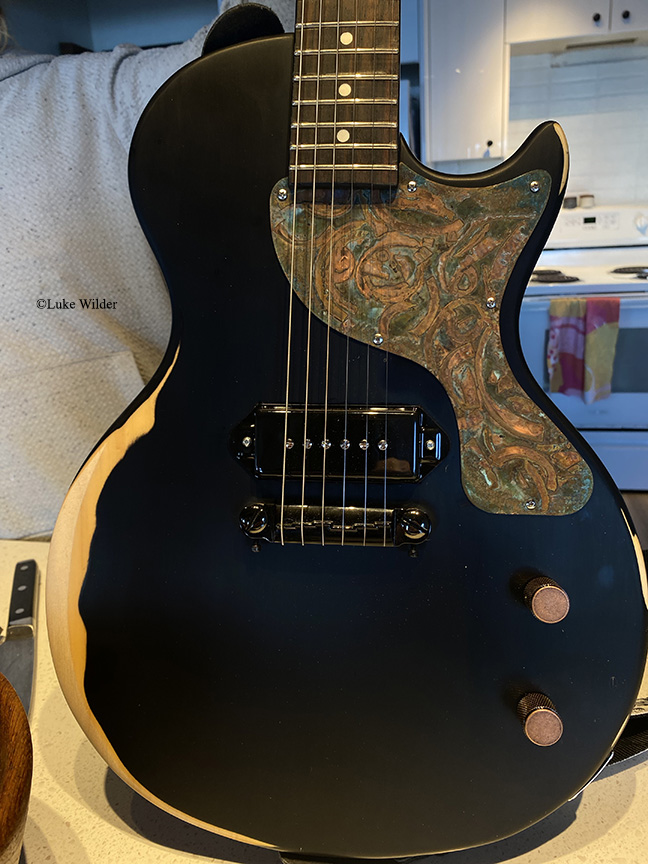

Here's a pick guard my brother did for his garage sale LP Junior. He put onion pieces on the copper, wrapped it tight in a micro fiber cloth, dripped a few ounces of ammonia onto the cloth, then stuck it in a large tupper ware for ~5 hours.
Man, both yours and his highly complement the specific guitars they are on, and neither would look good on the other guitar. The busyness of the LP guard would clash with the simple long grain of the telecaster, and the large pattern of the telecaster guard would look like someone stuck stickers on the LP.
