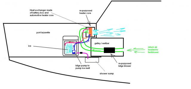

I'd even go so far as adding a quick garden hose connect to a through-hull in the transon. When in use it would reduce some of the head and then capped when sailing. When are we going on "Shark Tank"?What we have discussed so far only needs to be simply modified such that WHEN ANCHORED for the evening, all one might want to do is to toss a hose overboard and pump cold water up from the bottom to run through the heat exchanger.
