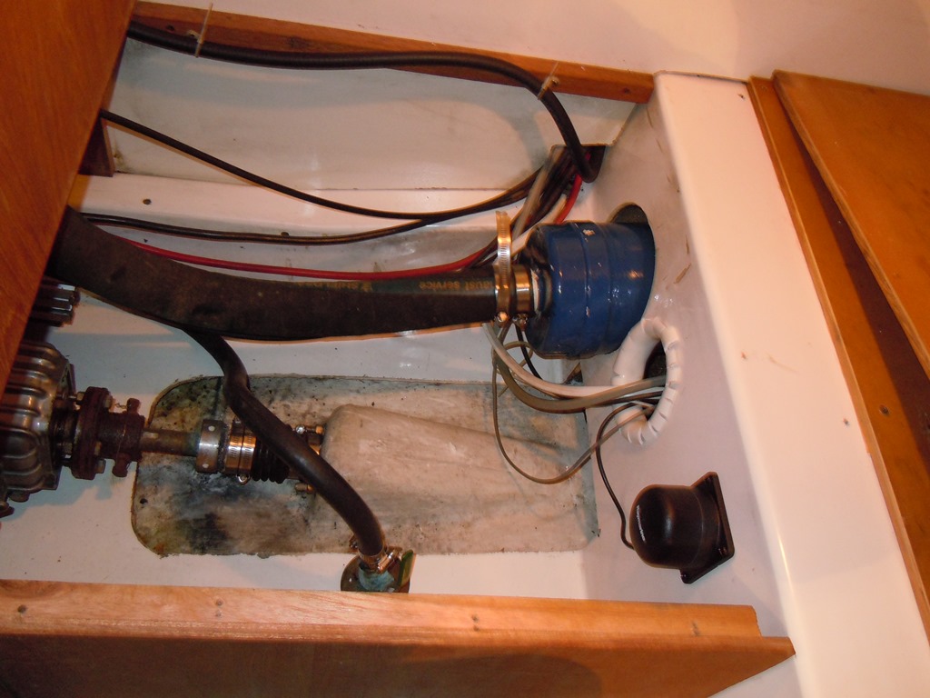

Mark,
I have been intrigued by where you mounted your compass as it would be right on the center line of the boat. It is pretty close to the engine there and doesn't it place right behind the little cubby hole at the top of the engine compartment? I've got all kinds of metal stuff stored in there that I was afraid would really mess with it. So, I mounted mine as you can see underneath the aft berth. Its about as far as I could get from the engine and the rudder post. As you can see, it is off center, but that builds in a safety factor. I always miss running into the bouys by at least 6 inches. OK that was a bad joke. It doesn't really matter that its off center as the boat is controlled parallel to the center line. No big deal.
I do have a really nice rolling tool bag that I used to keep right next to the compass in that foot well by the rear berth. I felt that would really be problematic so it lives upright at the v-berth. Now its just in the way always. That's why I was interested in how you installed your compass up higher on that bulkhead. I'd sure like to put my multitude of tools back under that aft berth niche.
