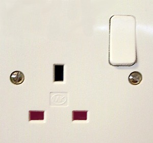

The plugs will be UK 3 square pin household outlets. Change those too.
