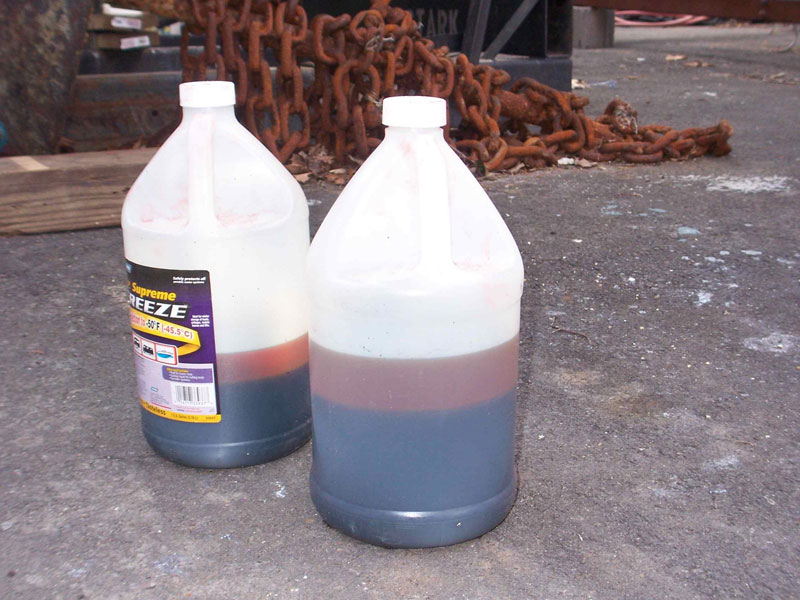

Ok, here's a photo of what the last gallon or so of my fuel tank looked like.
Wish I could find AV gas instead of using the E10 crap.

What's the black liquid in the bottom of the jugs.... dirty water?

I've be amazed if that amount of water was collected simply because of a 10% ethanol mix fuel! Doesn't seem conceivable!

I'll give you a hint: that black liquid is not gasoline! The amber colored stuff floating on top is old fuel that I also 'recycled'.
Perhaps some background info should have been included. Our boat has a 20 gallon fuel tank for our Atomic 4 engine. We typically do not use more then 1/2 a tank of fuel in a season but try to keep the tank topped off with Sta-bil over the winter to reduce condensation.
After about 10 years of this kind of use it became evident that the Atomic 4 was unhappy with the quality of the fuel it was getting so I pumped out the gas tank by hand. The picture above represents the last gallon or so I pumped out. I am fairly certain that our tank does not take on water from the fill cap. This is many years worth of phase separated alcohol absorbing water.
Luckily for us our pick up tube has a hole in it at about the 1/2 tank level so all that crap normally floated below the pickup. Just another system for me to fix on a 45 year old boat.
YMMV.

Over time. Remember: Alcohol absorbs water. Here's one of many articles on the problem: Phase Separation in Ethanol Blended Gasoline's

While it is clear you try to practice good fuel storage practices, there is one area where you have fallen down badly: no one has sugested that e10 can be kept more than 3-4 months, and yet you have extended that to ~ 2 years, and that is a probem. Would you go 2 years without an oil change? Of course you would not.
Run your engine more. Marine engines in sailboats die more from dis-use than milage. I know we are sailors, but that fact is an engine that is used regularly runs better.
Four additional points:
1. If you change the fuel regularly and there is no water leak, e10 cannot absorb enough to separate. The fresh fuel absorbs what little has entered with breathing.
2. Water absorbed from the air does little to contribute to corrosion problems. Salt water, on the other hand, is deadly. A few drops will tear up a carb unless the correct addative is in place (Stabil helps).
3. Additives that suspend water can make corrosion much worse (Practical Sailor testing).
3. Vent filters (H2OUT ADV and others) are effective.

What amazed me was that a 10% ethanol mix could create what appears to be a 50% water layer (probably greater). Either a miracle or science needs to revise the rules of mass balance.

Don,
My picture of bad gas showed the last gallon of a 20 gallon tank. Of that gas approximately 3/4 of the gallon had 'crap' in it. So even if it was a full gallon that is 1/20th of the tank capacity or 5% of volume, which is less then the 10% Ethanol contained in a 20 gallon tank (which would be 2 gallons).
I agree with the comments that suggest I need to empty the tank more frequently and 'rotate' out the old fuel.
