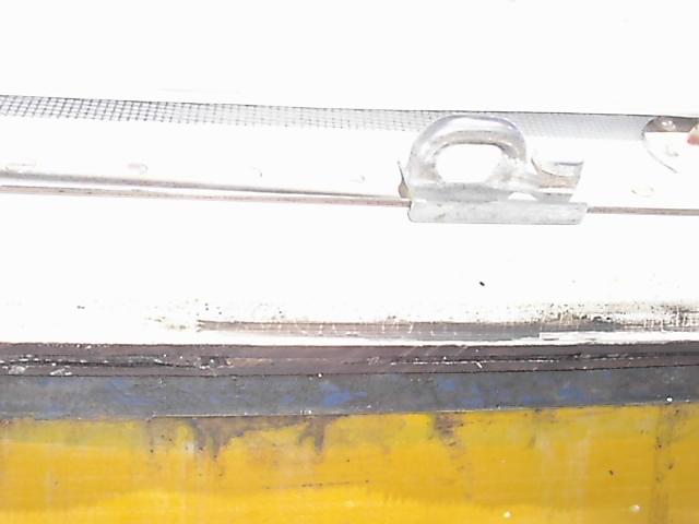

The only hull to deck connection appears to be the tabbing on the inside of the hull and deck. The screws that secure the rub rail on the outside have de laminated the end grain of the deck balsa. I have some alligatoring on the external vertical fiberglass surface above the deck. I wonder if the alligatoring is a sign of stress. I'm tempted to eliminate the rub rail, and glass the hull and deck together on the exterior. Thoughts
