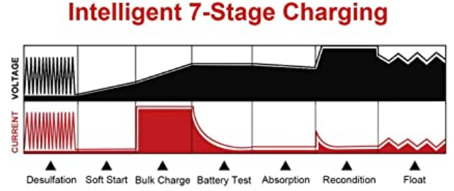

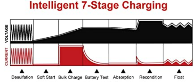

Here is a marketing graphic of a charger that performs a "desulfication" and "recondition" function. The two appear to be very different.
dLj
Mar 23, 2017
4,849
Gotta love the absolutely - no information - graphic... No scale, no values, nothing to define how or way they are doing each part... The graphic would imply that the float voltage is actually higher than the absorption voltage. Wrong. No time scale along the bottom. Are they controlling through time? Current? Something else? Gotta love the words though "Intelligent 7 -Stage Charging"...
Oh, by the way, the left hand side that shows the Desulfation - that's probably representing a method using a high frequency method of desulfation that has not been well accepted as working. There is a theory that high frequency pulses can be used to de-sulfate a battery. I've found a number of people that believe you can desulfate really destroyed batteries by using this method.
I tried this a few years ago with some batteries I had that were shot and could not get it to work. It seemed to me at the time to be a lot of hocus pocus, but there are a lot of folks that think it's great. From my perspective, until I see it work, I'm not a believer. Just a FYI - if you go into the forums that have the off-grid folks that are all talking about batteries and such in homesteading, this subject can be liven up the conversation faster than what's the best anchor in sailing...

JamesG161
Feb 14, 2014
7,962
Hunter 430 Waveland, MS
Graphics are used to easily explain to the layman, by visualization
I was curious and skeptical about my first Equalization, after reading the manual for my...
Freedom 20, boat inverter/charger.
It said full cycle lasted 18 hours, and I could interrupt it, if needed, but repeating is necessary.:(
____
So now the science, for 2 equally matched 12VDC LA, house batteries, installed at the same time, new. [ but after 6 sailing months use]
I hooked my DVM on one parallel battery, and clamp on DC Amp meter. Pushed the GO sequence.
[on full shore power, not much other power use. suggested by the Manual]
Now follow me, using that graphic, which is correct, and I will tell you the VOLT and Amps and some time factor too.
1) Voltage went immediatly to the max of 15.9 VDC and flat lined.
2) Current draw , just like the graphic, as the intense Reversing Chemistry started to "kick the plates awake" [main reason to do this]
Now see the Current slowly drop over about 3 hours to steady AMP draw. Why? Just the standard charging now. [more later on this]
So the reconditioning time line is battery specific, thus no numbers on the graphic. For my situation, 8 uninterrupted hours. [Corrected to 8]
Now why you cannot use my numbers, and why it varies over the age of the batteries.
1) Battery age and your treatment of them.
2) Amp Hours rating
3) Number of past Equalizations done.
4) You may have a different charger than mine.
5) The Amp flow drops, graphically above, to the Standard Charging amps, for my batteries, at that time. More amps are needed for different battery states.
Thus, the visual graphic, for the layman.;)
