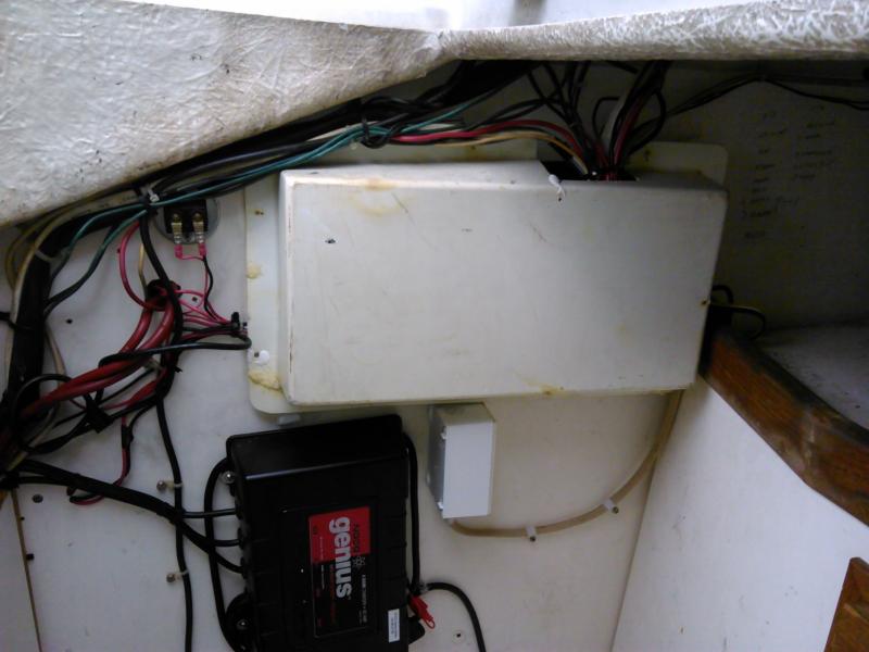

I charge my batteries almost exclusively off Solar through a Genasun GV-4 controller, the only other charge source being the 7A (max) charger on the outboard, which is normally putting out closer to 5A at normal operating RPMs. The GV-4 does not have a equalize function, and the dumb regulator on the engine limits output at 14.4v. (and if I really need to charge them over night as a result of extra heavy drain and no time for solar to recharge, I do carry a cheap AutoZone 10/50a automotive charger with alligator clips and a shore power cord, but I have only used that once in the last 2-3 years).
I tested all the cells of both my batteries (2x Group 24 12v) and I noticed that 2 of the cells in one battery are a little lower than the rest (I only have a cheap "4 balls floating = full charge, 3=75% charge..." hydrometer, it doesn't give actual SG numbers).
What is the best method to equalize the cells given my situation?
