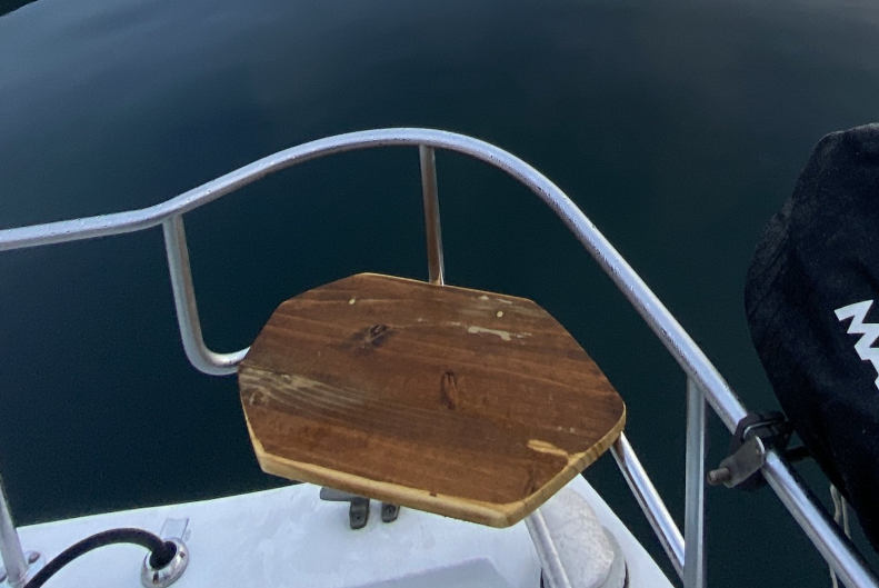

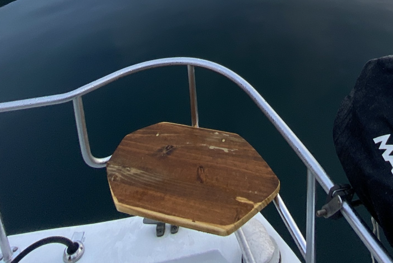

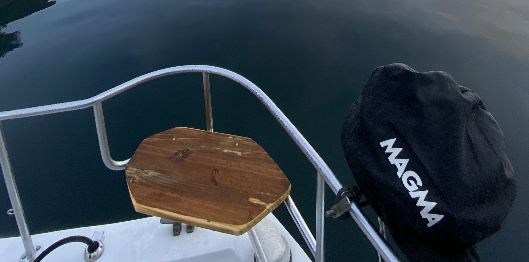

This is a pine stern seat. I sanded it and covered it with a coat of epoxy. Then since I planned to leave it exposed on the boat I gave it a coat of varnish. The problem with epoxy on pine exposed to the weather is expansion. It bubbles and cracks the epoxy. Then it flakes away. A good varnish will expand and contract with the changes in the atmosphere.

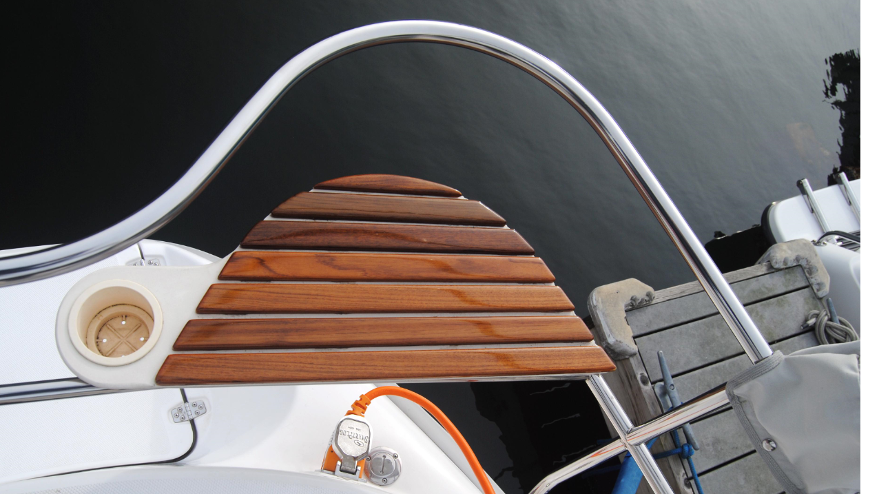

I think this is as close to an infinite life expectancy you're going to find :
The steps are about ten years old and still no need of re-varnishing. The underlying trick here is that I used a light glass cloth under the three coats of epoxy. The cloth is invisible as the epoxy and glass have the same refractive index. Lastly covered with three coats of spar varnish. Steps are not covered at any time.

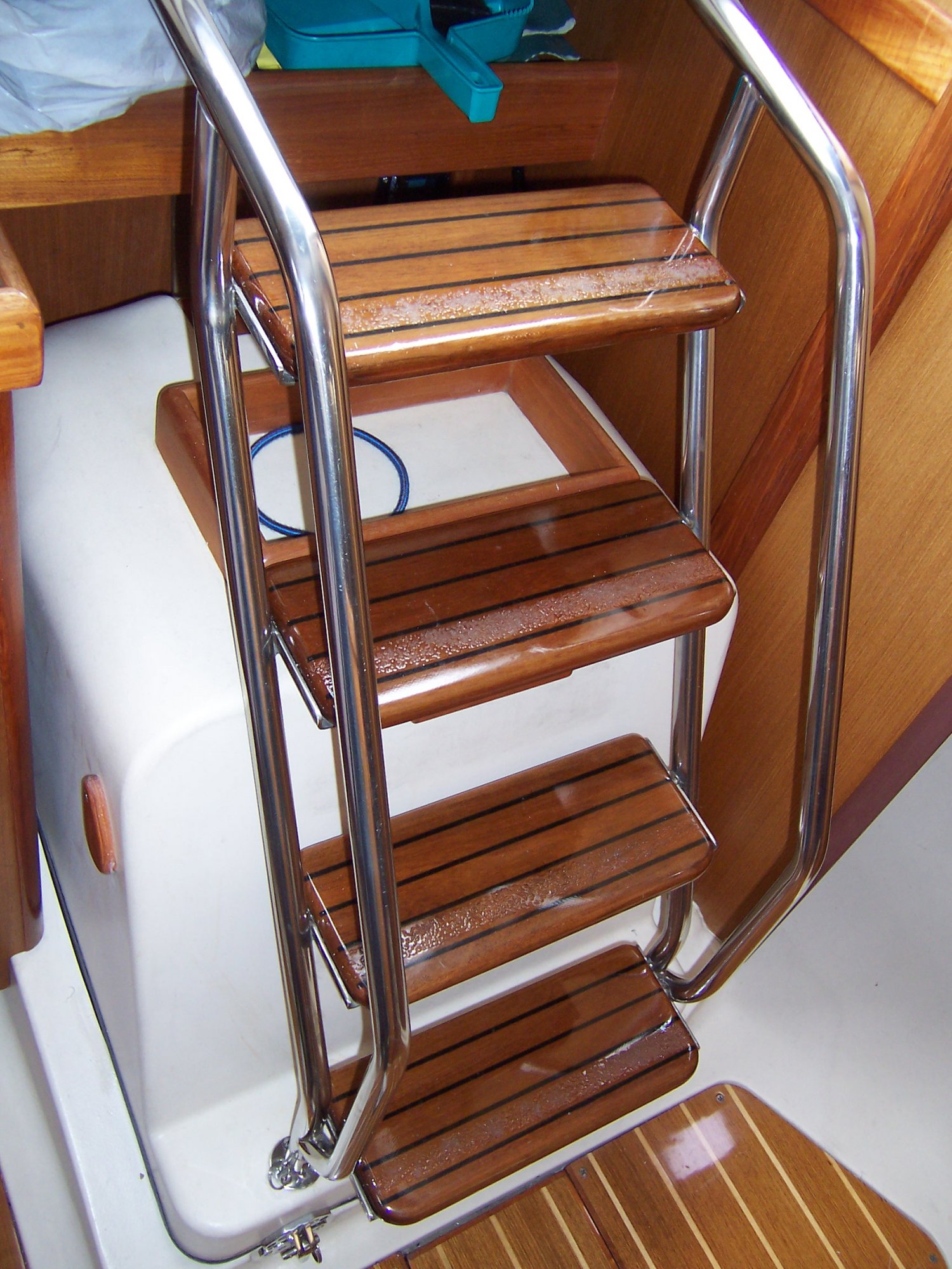

This is an outside application :
This only has Silver Tip Clear finish, no glass cloth but five coats of epoxy. Again, about three coats of varnish for UV protection. These transom seats are covered when the boat is not in use but they get plenty of exposure in the summer.

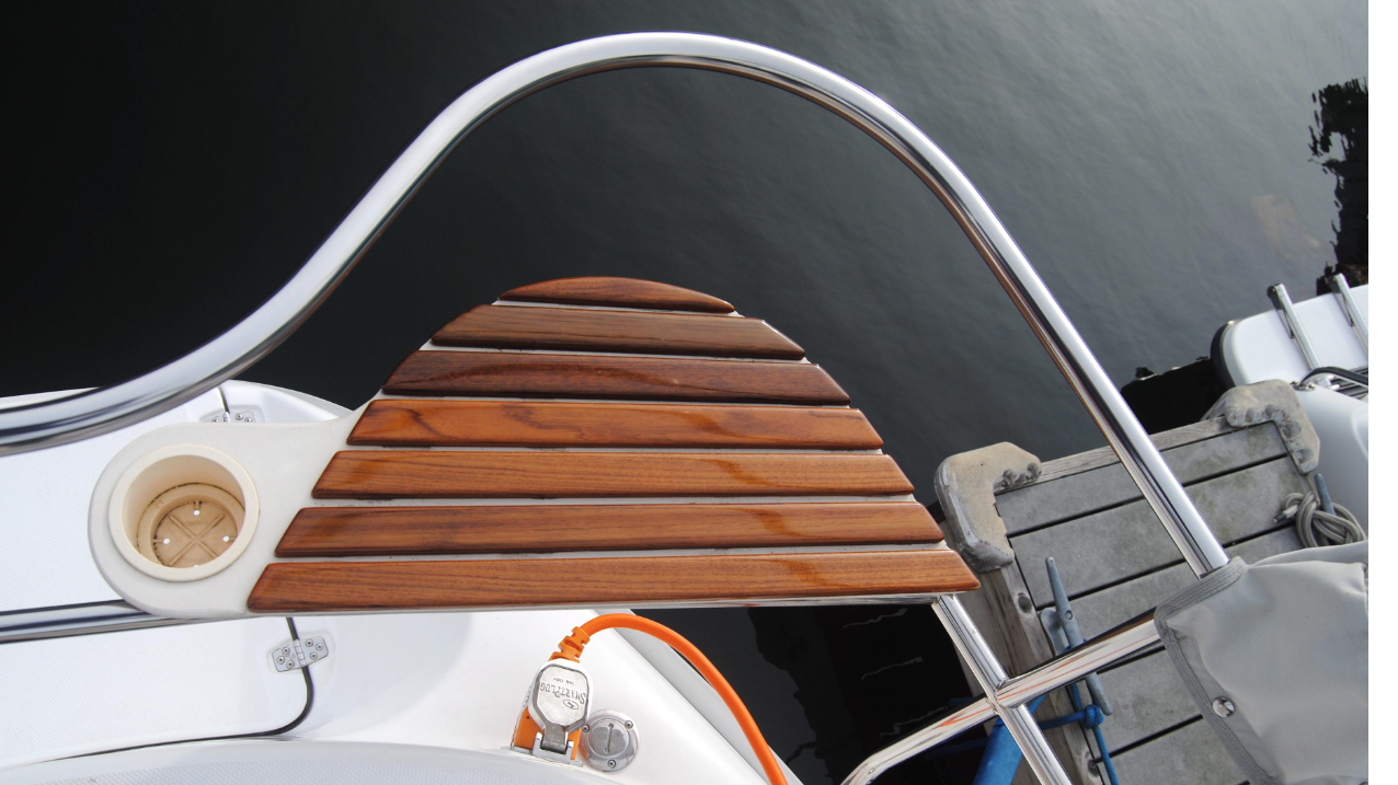

I assume you take the slates off the diva seats in order to 100% encapsulate them. How do you affix them to the starboard once you have completed your beautiful restoration?

The slats are removed to seal them with 10% thinned epoxy on both the top and backside BUT to ensure they are 101% encapsulated when they are screwed back on to the starboard, the original screw holes in the teak slats are filled with Big Box GE Silicone Bathroom, and Kitchen, and aquarium, and Tub, and Everything Sealant because I believe silicone DOES have a place on boats contrary to what the purists say. (Phew !). The above mentioned silicone sealant, just by being there, is in itself sealed from the environment and resists any degradation.
The teak must be hermetically sealed against moisture intrusion. IF moisture does get into the wood through any tiny crack, the only way out is through that same tiny crack and that's just not going to happen once the moisture has dispersed through the extremely dry teak (another mandatory requirement). The resulting water vapour pressure is going to pressurize and break the bond between the wood and the first layer of epoxy. This is quite likely what happened in @jssailem 's stern seat :
Done correctly, the pine stern seat should last a long time. Even longer with any sort of protective cover.

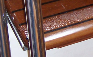

It's all in the fine details :
The rough surface is caused by a crushed quartz anti-skid product being applied to the second coat of wet varnish and once dry, covered with a third and final coat of varnish. This was done as a 1" strip of anti-skid as I couldn't run the risk of covering up the fine teak finish. That would never do. Just ignore the broken ankles. "Walk it off. Walk it off ya sissy."
Also, the black strips in the teak steps are the product of a long wet winter. Just as a make-work addition, I dadoed out the 1/4" grooves and then poured in black tinted clear epoxy. DON'T ask me why I used black as I have no idea whatsoever. All I can figure is "like ya know, an acid flashback to the sixties man ?" Once I had finished the steps and before installing them on their SS tube frame, it dawned on me that the steps were supposed to match the flooring with a 1/4" strip of blonde holly, not black ebony.
