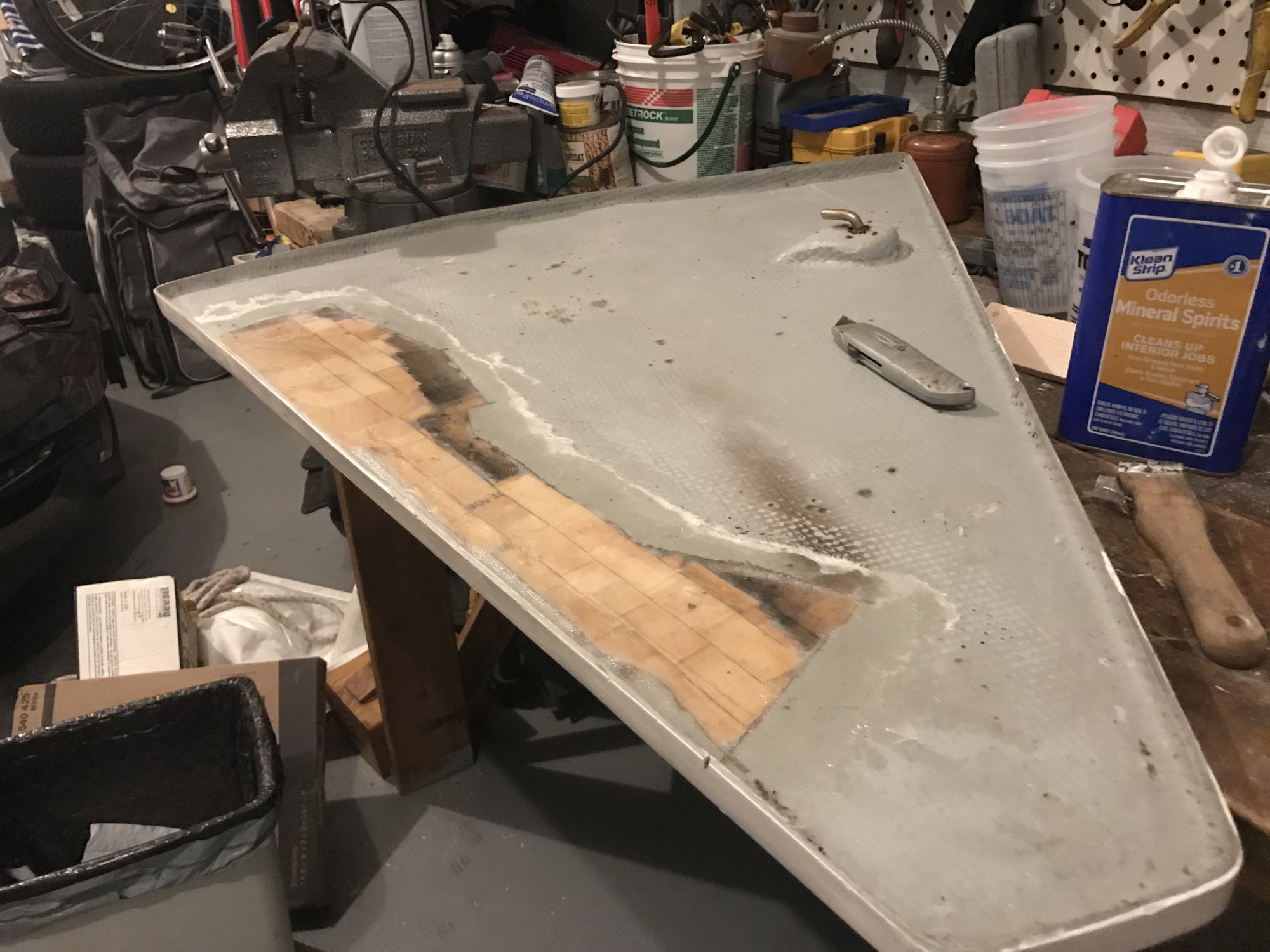

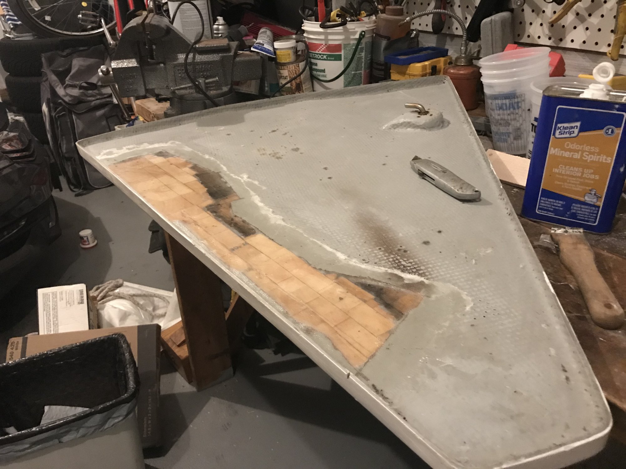

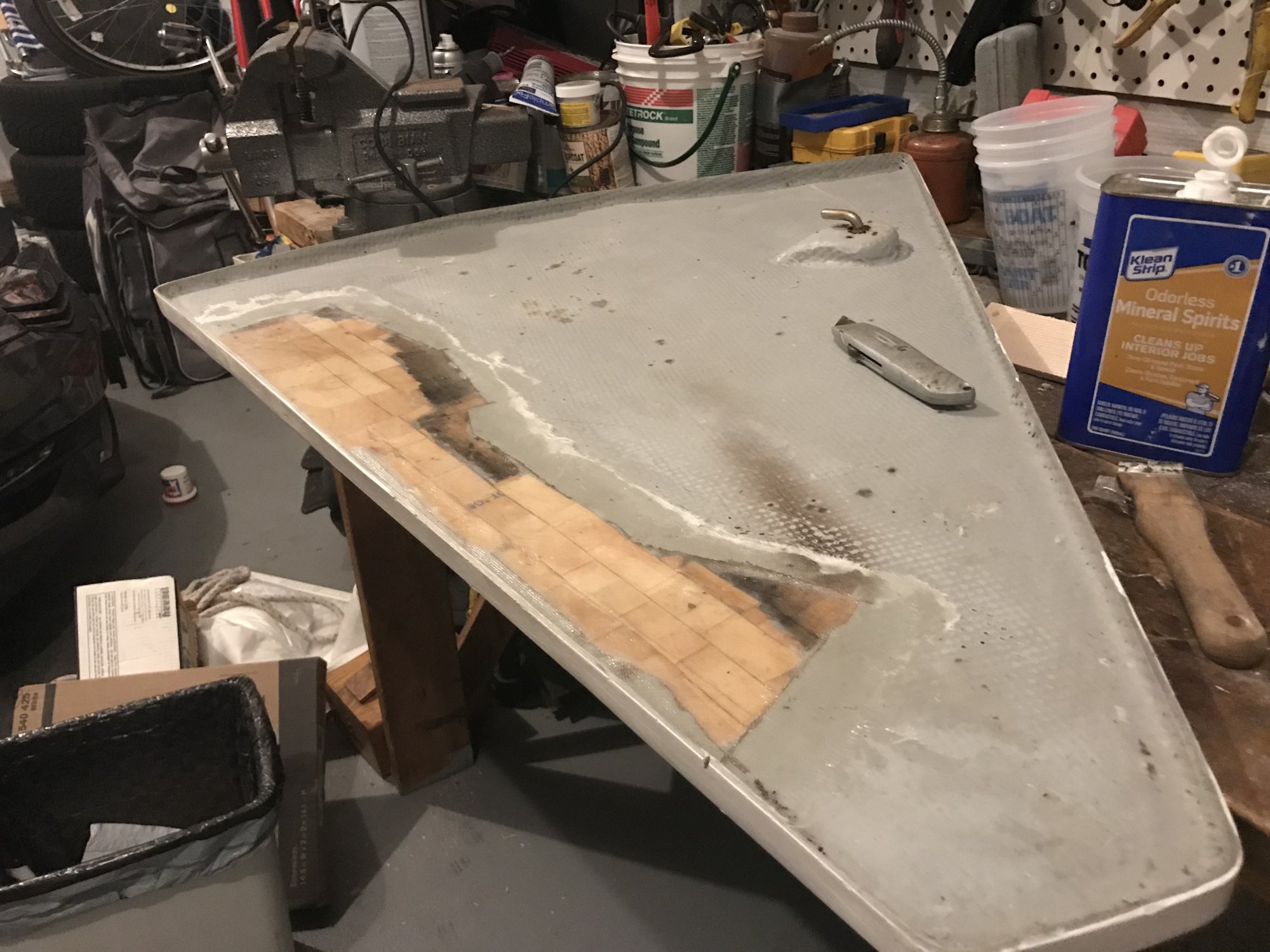

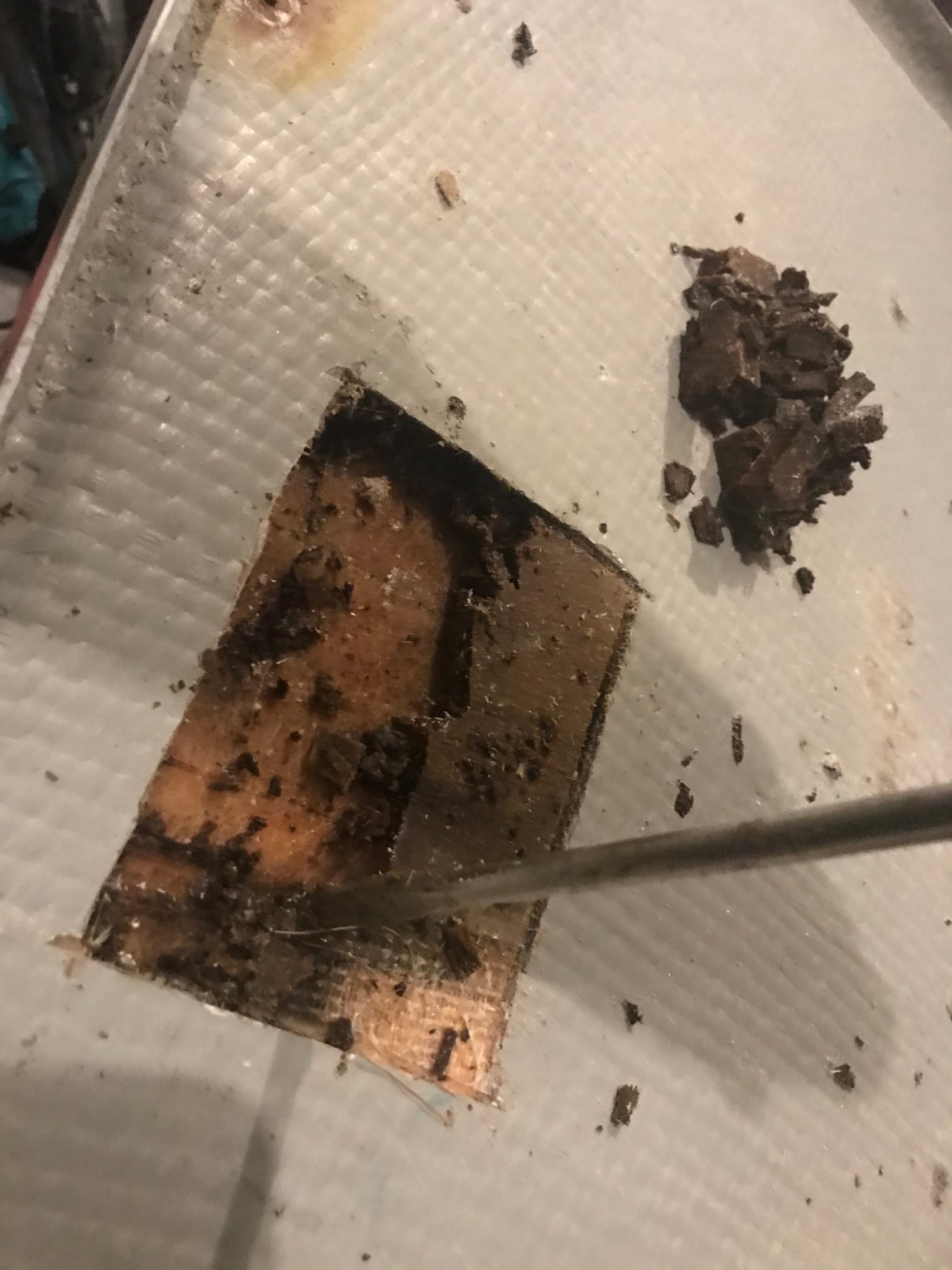

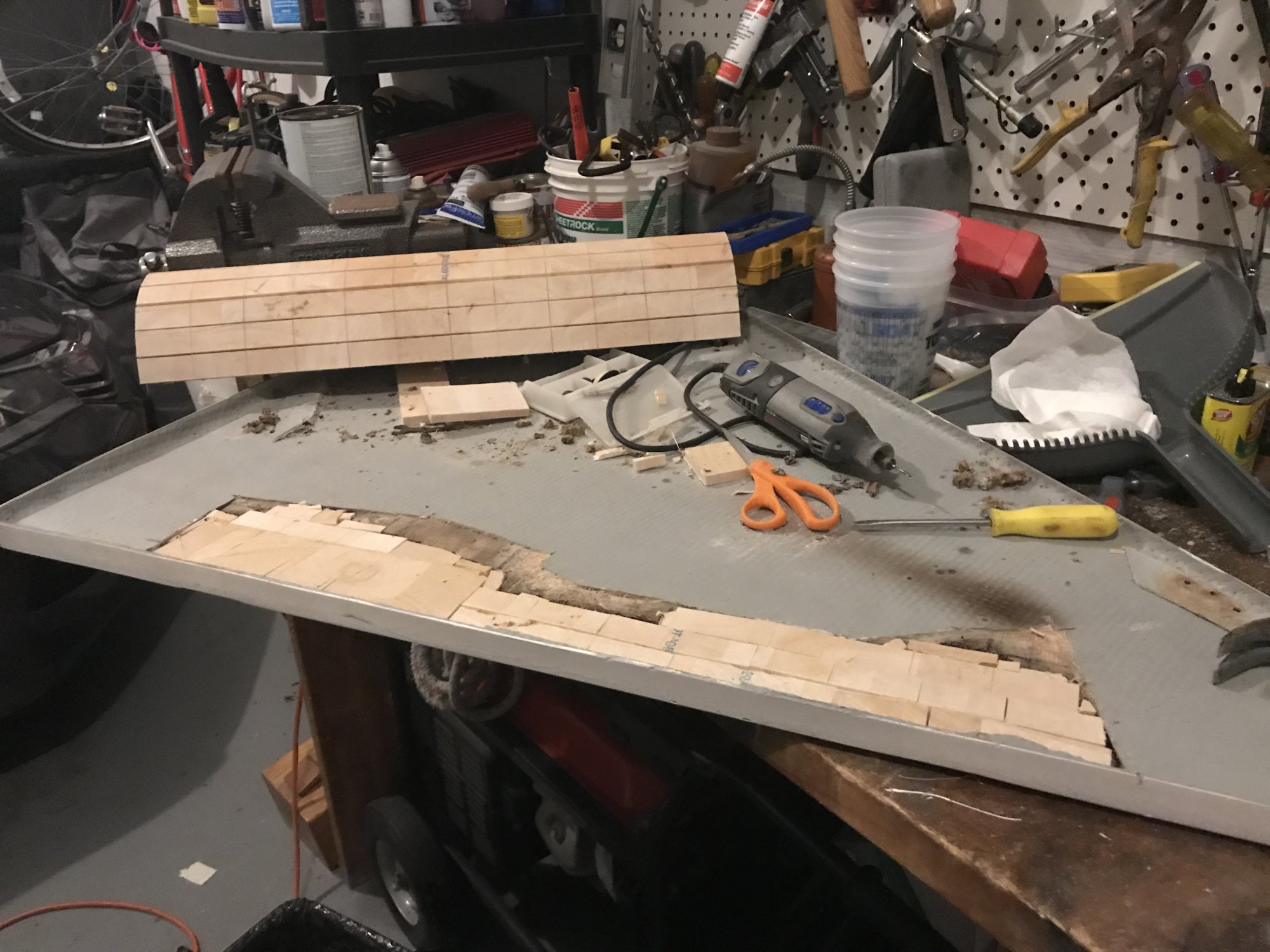

Total Boat. This anchor locker lid had core soaked with water, balsa end grain, easy enough to replace, went underside to preserve nonskid pattern on top. Started as a small job, Not a fun job, not easy to match texture, used total boat fairing compound, then I painted it...couldn't match gray color...don't have picture but imagine an inner gray and dark gray camo pattern. Good part is lid is solid, water proof, and job is done. Good luck.
Likes: SailingLoto
View attachment 188446View attachment 188447
nice work
