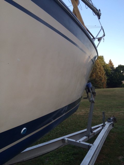

Enlighten me--dark/light spots on hull
Apr 25, 2015
282
Oday 26 Oscoda, MI
I hope the attached photo is good enough to see the dark & light spots on my hull. This is after wet sanding with 800 grit. I will move onto 1000 and then 1200. Since I have never wet sanded before, I was just curious if this is a normal thing.

Did you first compound with something like 3M Super Duty? Were the marks there before you wet sanded or only after? General rule of thumb is to use the least aggressive agent first (polishing compound or rubbing compound), work up to more abrasive stuff in steps only if results not good, then stop once results achieved and then go back down the latter to the rubbing compound and finally a coat or two of non abrasive wax.

I also think that polishing with a product like 3M Heavy Duty would get a more uniform result. Follow with liquid marine wax.
I used it on the 30 year boat I bought a couple of years ago. I actually thought the hull was white when I bought it. But polishing removed the oxidation and brought out the true buff color and a nice shine (see photo)

I don't know if is normal or not, but to go thru the effort to eliminate random discoloration on an old boat seems way too exhausting to me. I always see the color imperfections in my old boat when I look closely. When looking from afar, she looks lovely.
I think that if you go thru the effort of wet sanding, compounding, polishing and waxing ... you've done enough. You might still have some discoloration, but your topsides will still be smooth and gleaming. That's more than good enough to put your tools away and go sailing!

I believe the marks were there last summer after I bought the boat but not 100% sure. I think I will clean it with FSR and see what happens. I am trying to get away from compounding etc. due to a torn rotator cuff. I need to get this baby in the water next spring for sure and have been doing all other things to it and I am done except for the hull, build a mast raising system and installing a composting head. I know several will go unglued on my nest statement but hear me out. I am planning on wet sanding it with 800 & 1000 and maybe even 1200 and then cleaning it and then using PoliGlow or FSR. I am not going to pay somebody 600-800 to compound and buff it for me. I purchased a pneumatic orbital sander with adjustable speed and wet sanded the first side yesterday with 800. I was hoping to go to 1000 next and then either FSR or Poliprep and then Poliglow. It may not be perfect but I really need to go sailing next summer. I have owned many powerboats but now I am itching to go sailing on the Great Lakes. Hell, I even bought a slip on Lake Huron and look forward to just playing around kayaking, fishing and sailing for a complete summer (our summers are short). UGH!

Orbital sander with 800 grit? Looks like you sanded through your gelcoat. That should have been a hand sanding job up to 1200 finished with compounding via an electric buffer. Just enough sanding to get through scuffs, scratches and heavy oxidation. And yeah, it is worth $800, probably more, because it is a lot of work.

I dunno. It looks inconsistent like gelcoat will look after sanding, but before compounding and polishing. Except for a few spots which might look a bit tan-ish, yellow-ish, which to me looks like tannin stains. I think some oxalic acid/On and Off/favorite acid based cleaner would help with that. 'Course, I would have hit with the acid bleach before sanding...

We had the same issue and found an easy solution. It worked so well, half of our club used it as well. We got our hull consistently and uniformly white.
What did it was the powdered Barkeepers Friend. A bit of it on a damp rag and the dark patches vanish. I'm sure it's the oxalic acid that mostly does it but when I tried pure oxalic acid it didn't do much.
You need to constantly add powder to the damp rag. Once the powder dissolved it stops removing the stain. Supposedly this stuff is mildly abrasive but I could not detect any visible abrasion.
Everyone who saw the boat borrowed the stuff and used it.
BTW I tried every other product including "on and off" and none did the same job.
Bonus - the stuff is cheap! It has to be the powder - the liquid does not do the same job.
Give it a try before you reject it...

It just looks uneven to me. I don't know if I would try wet sanding with a pneumatic orbital. I do it by hand. Put the sandpaper on a flat sponge for a backer. Usually side to side strokes. Sand each finer grit more than you did with the previous grit and it should come out nice and even.

What is the original color of your gel coat? Some boats in the 80's used an off white color. The darker parts might be the original and the white is the oxidized part. I am with Scott T-bird, I have some slight imperfections but from a distance it looks fine. Also, if you read Mainesails directions he specifically says to do the wet sanding by hand.

My gelcoat looked like that too after wet sanding. I figured it was normal for a 36 year old gelcoat having it's thin and thick areas. I know when I pulled the original cove strip off, the gelcoat under it stood proud of the exposed gelcoat by quite a bit. My gelcoat is thin and old, that's why I am not going the wet sanding/waxing route this time and just use Poli-glo. I heard it's great if you do your yearly maintenance.

Ya the boat looks awesome from about 50 feet if the light is hitting it right. I just picked up the Barkeepers stuff and will give that a try tonight or tomorrow.
I can't hand sand it unless I want physical therapy for my rotator cuff again and that was 8 weeks last year. It'll be Barkeepers to see if those dark spots will go away, then orbital sand (I do it very lightly and keep it wet all the time) an then Poliprep and then Poliglow. It'll have to be good enough. I have other stuff I have to do before snow comes and that can be in October some years.
