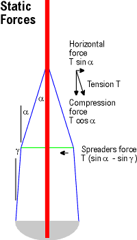

A force diagram should look something like this
Although, this is a simplistic diagram that does not show the angle of the spreaders. Ideally, the spreaders are angled up to bisect the angle of the shroud above and below the spreader end. By setting the spreaders horizontal, the forces change slightly. The compression force is calculated for the bisecting angle only.

As per diagram
For T equals the tension in the cable,
ang A equals the angle between stay and mast head,
ang l equals the angle of the cable below the spreader,
the formula is;
T (sin (ang A) - sin(ang l)).
(For angle l = 0, ang A = 44 deg).
(sin 44 deg) = 0.6947).
37,5000 (0.6947 - 0) = 26051.25
Then
Multiply it by 2, since there is equal tension from both sides.
-Will (Dragonfly)

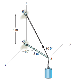

ahhh, MATH problems! Fun for some, and frustrating at times.
Cable tension provides the same load along it's entire length. When the "spreader" re-directs force direction, it then begs for vector math:
Here is a quick google search for cable force vectors and something that looks like your question:
