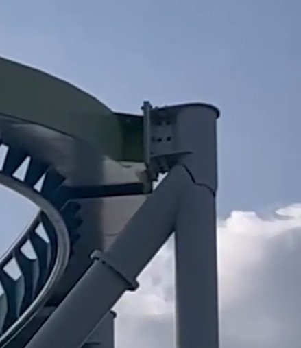

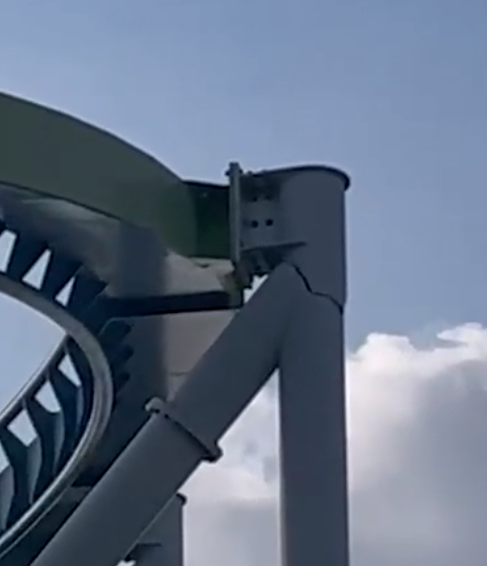

It'll be fine. It returned to its original position, didn't it ?
Before car went past.
After cart went past.
Well, almost anyway.

Very scary. Kudos to Dad for reporting it to park services, then following up with FD. His actions may have saved many lives.
Nov 21, 2007
673
I saw this video this morning and wondered, how did the park safety team miss this on their AM inspection.
There was another earlier photo which showed a smaller crack. Possibly a couple of days, at least, since it first appeared. How many inspections missed it? As a life long coaster fan, all I can say is :yikes:!

so this is going to be interesting. Root cause could be bad weld that propagated, Bad material, poor design resulting in high stress or Fatigue of the metal, My guess is that all of the other supports should come under scrutiny. The bad weld can be inspected for (xray welds). Bad material can be determined by post accident testing of the failed piece and other supports to follow. Poor design of the welded joint would involve a look at the whole coaster. Fatigue could be determined by post accident inspection of the failed piece under a microscope. If fatigue is the case, the solution is going to be a huge deal. All of these are going to take time and lots of $$$.
