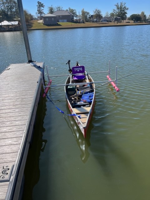

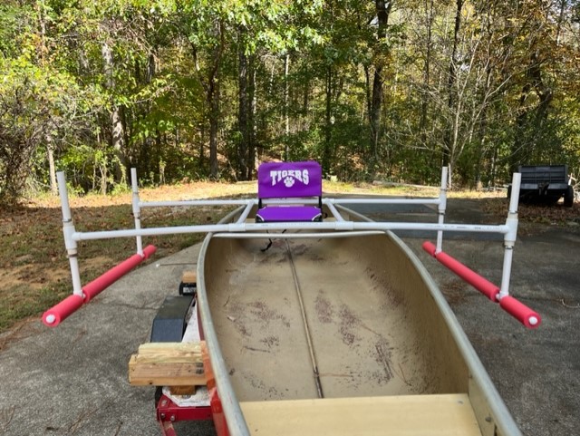

Here you go!
The wind was too high today for testing.
All should remember that aesthetics was not a concern especially for a 30+ year old Sears canoe. It was all about comfortable FISHING without breaking the bank.
The frame is 1". The cantilever ends are 1" to 1 1/4". There are 1 1/4" pieces used as bushings for the pontoon section. The floatation is held with a piece of 3/4".
My greatest concern are the cantilevers. The pontoons will displace about 10 pounds which is distributed to the four cantilevers. Each cantilever will have about 10 pounds at the beam. I hope the stress doesn't break the glued joints. I have a solution in mind if there are problems. I'll report back after testing.

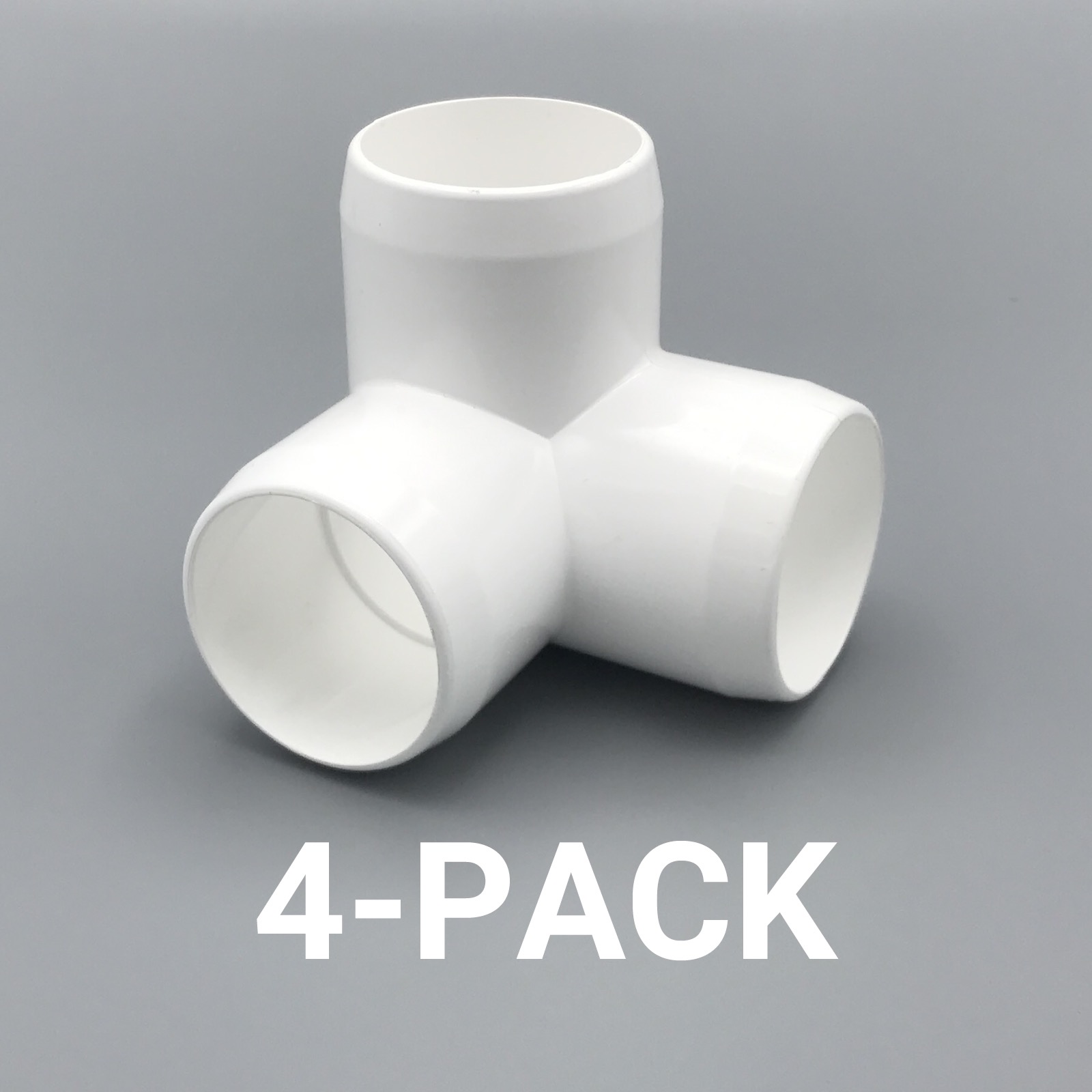

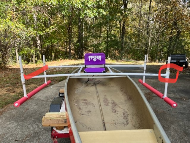

Great project. An interesting design. I’ve used pvc to make soccer goals. Looking at your design I would add cross members to each of the pontoons fore and aft. You’re going to get a lot of twisting as the forward end of the pontoon rises and falls. This is going to upset the structure and reduce the anticipated 10 lb support you desire.
I would use a piece like this for the red circle area the run a straight piece between them to keep the pontoon in plane with the canoe gunnel
Rather than these you used.
Thanks. I am aware of this issue. I want to test and study it. I'll do some bracing as needed.

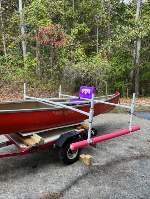

OK, for those interested. I still have some refinements to do, mainly, cutting the upright pipe.
That is a 40# trolling motor and will cruise the canoe at 3.5kts.
