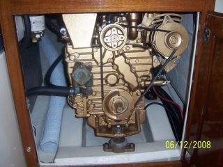

I occasionally peruse Craigslist San Francisco area out of curiosity to what boats are for sale. Recently is a 1983 38' Catalina for $35k asking. (By the pics and description seems to be a really super motivated seller... looks to good to be true. I would be tempted, but I like my existing boat enough and it's a Cherubini, would have to go through the hassle of selling it, like this forum a lot, etc, etc, etc ....)
Anyway, from the craigslist url for the boat, here is a pic of the engine as it looks now. Not only is it clean and gold, but the engine compartment looks spotless.
