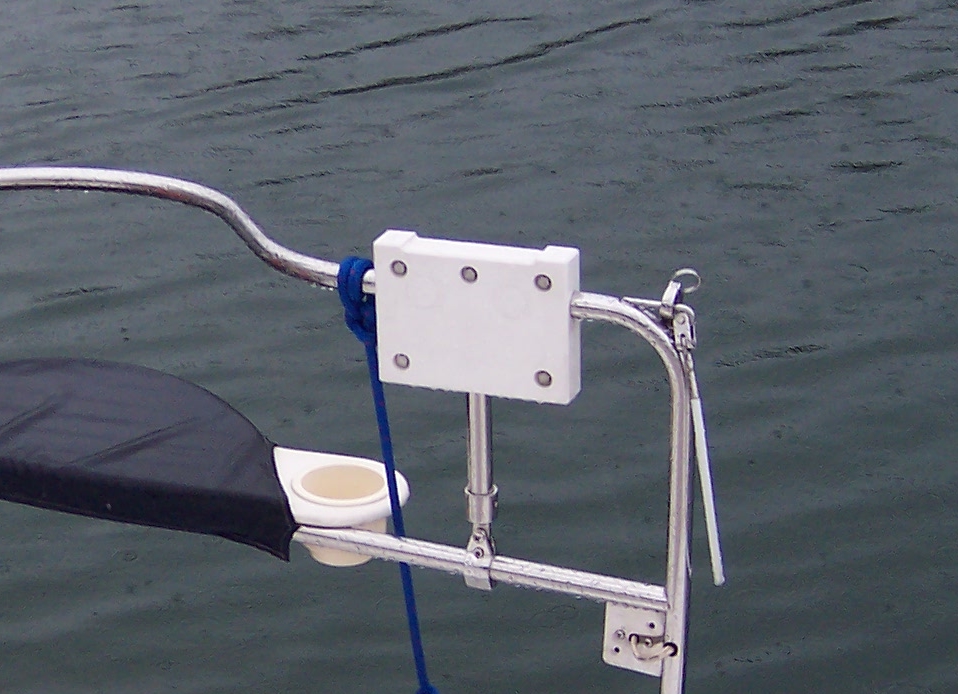

Once you get a lighter motor, here is a more compact mount. It's solid enough to stand on but you don't want anything too heavy sitting there at that height.
For anybody sailing with their motor on the pushpit, it isn't about the strength of everything at rest, but rather the torque from the motor on the pushpit underway, especially in snotty weather, like crossing a channel down here during Christmas winds.

Anyone have any ideas on how to do it without having to drill holes in the boat
Probably not. I have never seen a crane or davit-like lifting thing that attached to the boat without requiring at least one bracket attached to the hull or deck with screws or bolts.

I'm trying to figure out the best method to winch a 15-20 HP Engine off a dinghy and mount it on the seat rail on the stern. Anyone have any ideas on how to do it without having to drill holes in the boat and anyone know the best setup on the market to mount the engine on the stern seat?
Getting back to the OP - I think "without having to drill holes" is the non-starter.

Now if I were @Pumkinpie I would look at the Dinghy Sling from Harbormen. If you poke around my blog you will see my write up. It's also in a past issue of Mainsheet. With the dingy you describe this will be a perfect fit to lift the dinghy flat against your transom and get it out of the water for longer passages without having to add any hardware.
For the motor, I would get the nylon lifting handle. You could use that with a halyard to help lift the engine off the dinghy and put it on the boat. You could even add an opening block to the boom to help with this. Something like this mounted near the aft end of the boom to hold and guide the halyard. This would turn your boom into an engine crane for maybe $50 ($200 if you had the yard install it). Just line up the spot on the boom with the spot where you will store the dinghy.
Now for engine storage, the easiest answer would be to put it in your lazarette. But that's valuable storage space for other stuff. And the engine might not fit. So if I was going to use the rail I would probably start with buying the good Edison rail mount. If I recall correctly that has an intergrated cleat on the rail, if not you could use a soft shackle right on the rail next to the bracket. Make up a block and tackle with an intergrated cam cleat (you probably have something like this for your boom vang if you don't have a rigid vang). Install a folding padeye with a decent backing plate so that you can pull the rail in the opposite direction as the engine. When you put the engine on the rail, you attach the block and tackle and pull on the line slowly until you feel it counteract the engine. You don't want to over pull. I would also take the precaution to put a real backing plate on my rail supports, not just fender washers as might be there. Another option would be to add stainless steel pole supports to do this. But that's more drilling and planning.
With the boom snatch block and padeye approach this would only require 3-4 holes in the boat and 2-4 holes in the boom (then tapping those holes).
