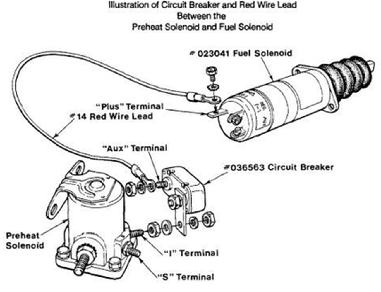

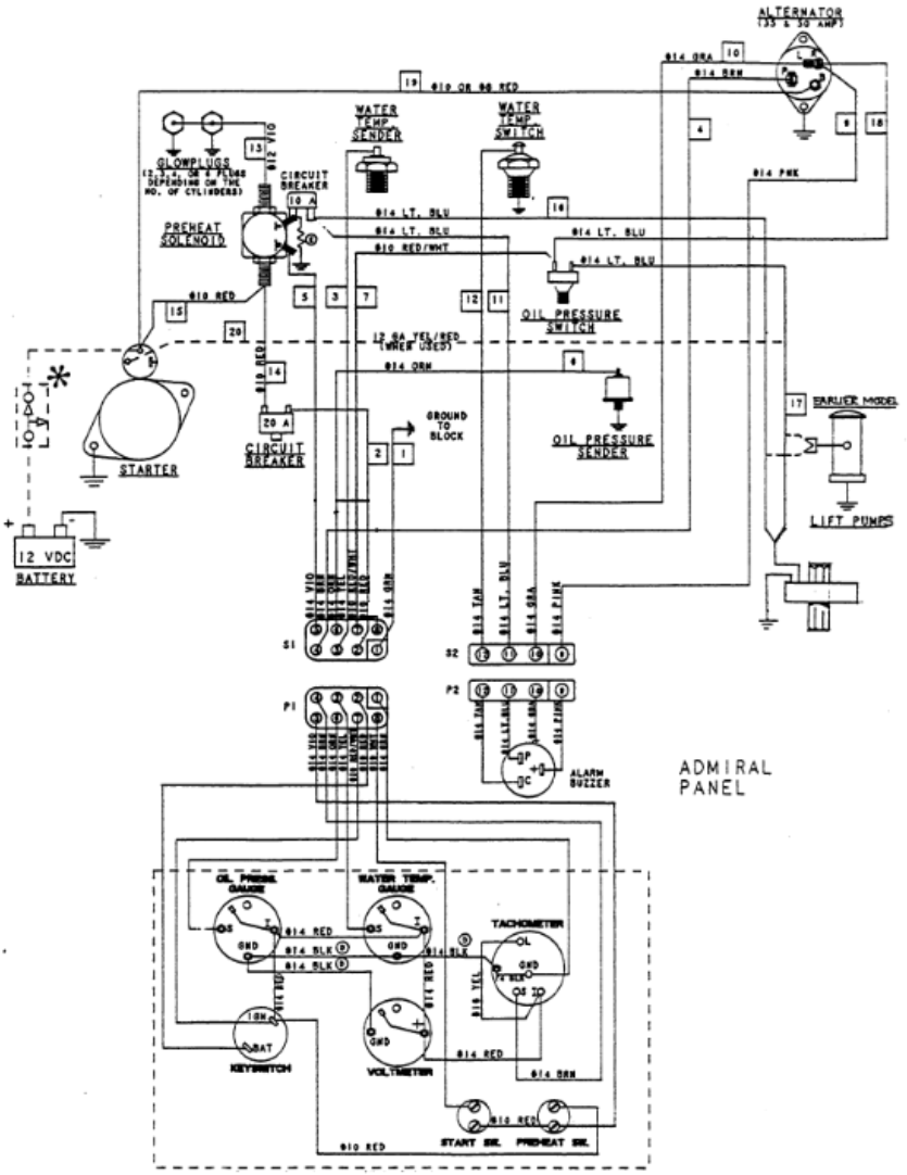

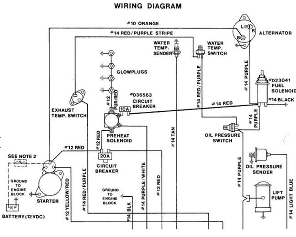

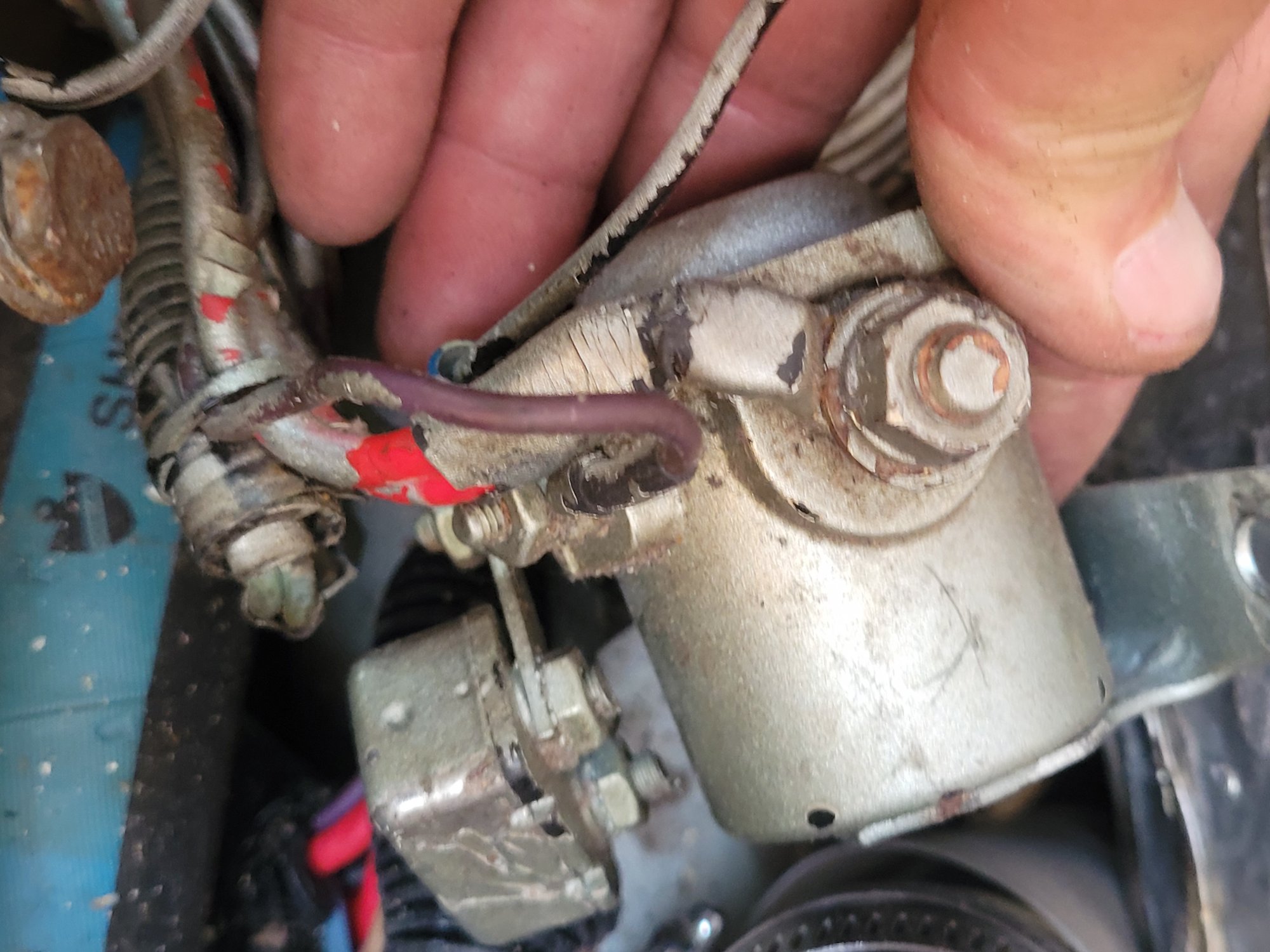

I could also use some info on the PreHeat Solenoid as I took pictures of it before I disconnected the connections (I pulled the harness today and am planning on doing an ohm check in the morning) but the only marking on it is "12v" and it would be nice to have a better idea of what connections/colors go where (there are 2-3 different sizes and connectors so that helps). When I google it, I get the solenoid for my Kubota tractor which is not what this is.

FWIW, I found the wiring diagram for the Preheat Solenoid, makes more sense now.
