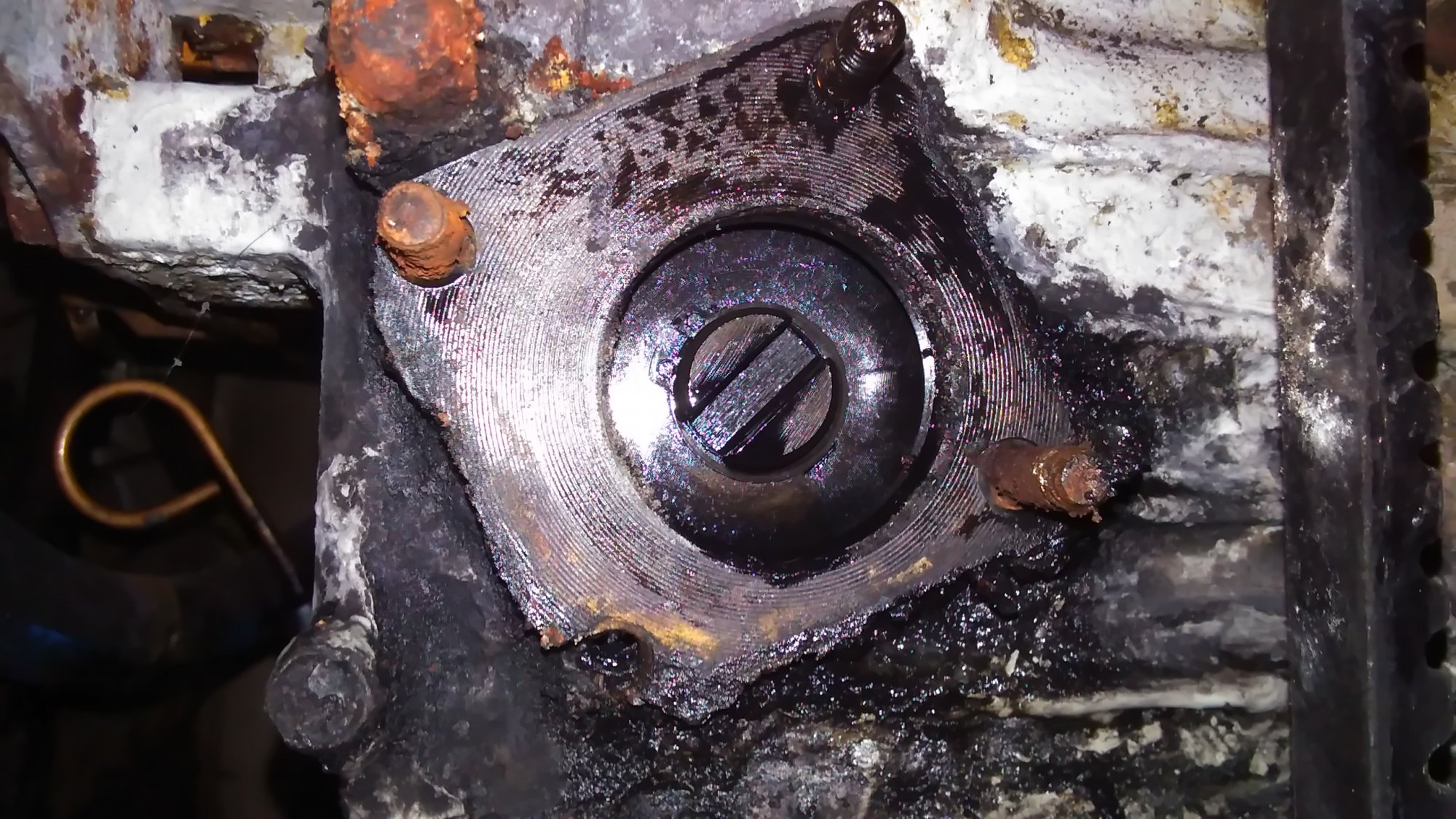

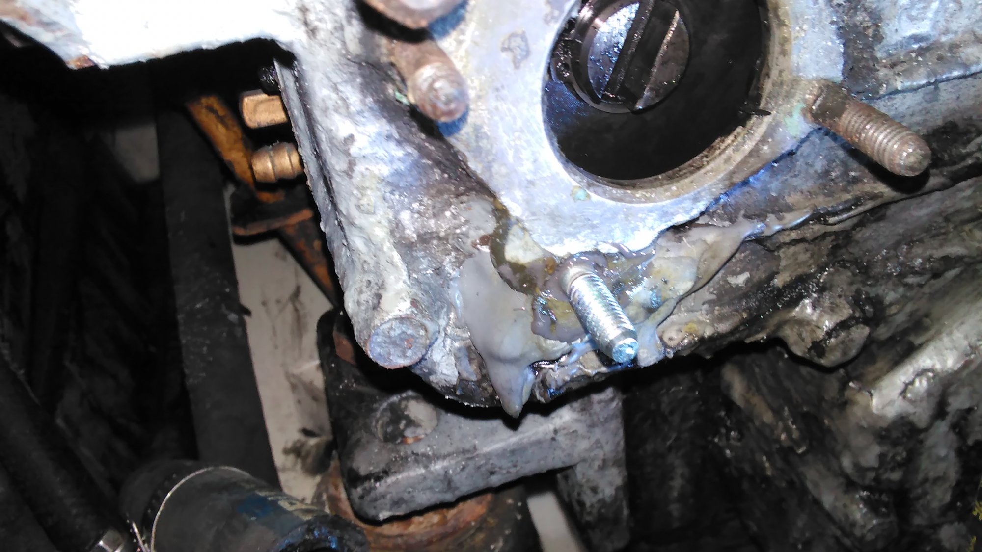

I once had one of the four studs holding my Oberdorfer raw water pump "disengage" from the gear case cover! Upon close inspection it turned out that the aluminum of the gear case cover that was holding the stud to it just disappeared! I repaired it with Devon, JBWeld wasn't strong enough. M25 engine. Reason for this story is this event spilled oil all over port side of engine. Just another thing to check.

Good to know about the repair to the treads for the Oberdorfer studs. Can you tell me more about this Devon of which you speak. I know of one fellow C30 owner who replaced the front timing gear cover this year due to stripped raw water pump studs. She found a used one in the UK and had it sent over at great expense.
In my case, the oil is not coming from the Oberdorfer because all of the free-range oil is on the back half of the engine. Front half is still nice and clean. There is also no oil around the injection pump. Most of the oil is bubbling out from the rocker cover near #3 injector. There is a lesser leak coming from the exhaust side of the rocker cover a few inches from the rear of the head. I say it is percolating because you can see bubbles of oil and air coming out of the gap. It reminds me of my visit to the LaBraya Tar Pits when I was a kid.

It is called DEVCON. Sorry I misspelled it in my last post. This is a representative sample close to what I used:
I'll see if I can find the actual article I wrote for Mainsheet magazine over five years ago and let you know.

So, did you use it to glue the studs to the cover or fill, drill and tape new threads? timing gear covers are getting harder to find for these engines.
