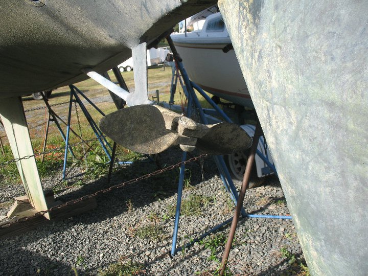

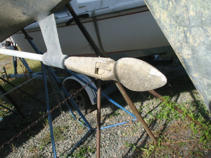

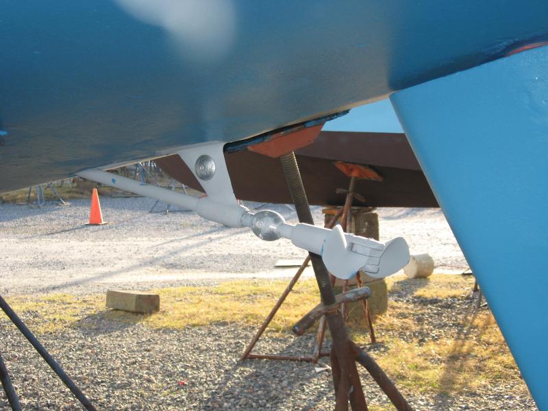

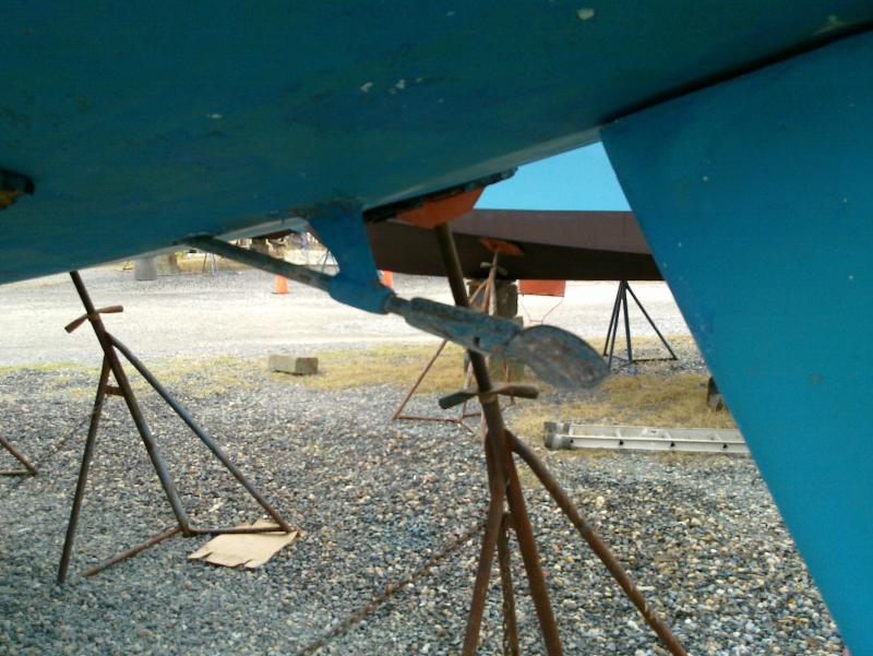

Would vibration like this be an issue by itself with the extra shaft sticking out? You can see before and after pictures. . .I didn't even notice when I reinstalled it that it was longer
If a balanced and true prop were installed, would the extra shaft matter much?
