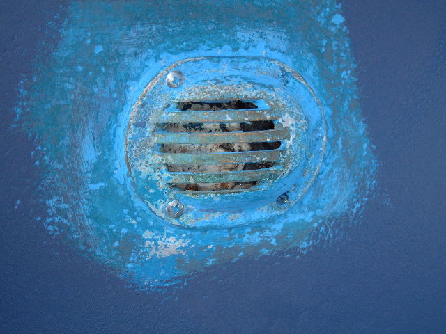

I have a 2005 Hunter 33. I'm attaching a photo of the strainer (slotted strainer?) on my engine through hull. It looks pretty bad to me. Can I remove it to clean it out? Or should I just poke all the junk out of it? Should it be replaced? Thanks. Herman

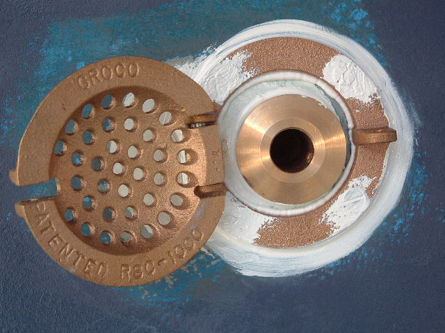

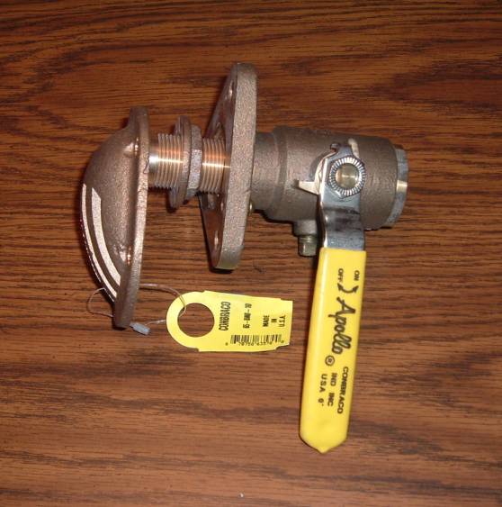

My strainer is part of the thru-hull(picture). And I have never had anything inside it like I think I see in yours. If yours is like mine you could remove the seacock or valve on the inside and then clean out the through hull. The strainer looks fine.

Thanks Ed. The picture explains a lot. The holes in the strainer are not used, right? As I remove the seacock do I have to worry about the thru-hull/strainer turning?

Your strainer has four bolts if I understand the picture. So it should not turn. Not sure what you have inside. But corrosion is unlikely so it should turn off the thru-hull without much effort. If you do have a real seacock it could be secured somehow. But not with bolts because you would see them in your pictures. What I am trying to say is that the four bolts seen in the strainer do not(usually) engage the seacock.

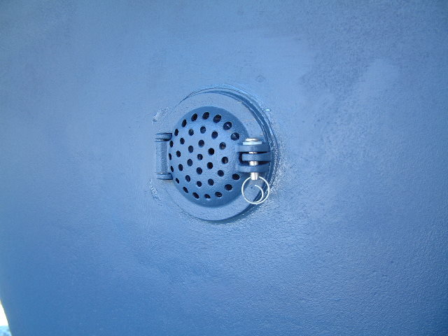

My solution was to replace the thru-hull with a standard unit and then install a separate screen with a hinged cover on the outside. The cover can be opened to gain clear access to the thru-hull by pulling a pin.
The pictures below show my original one-piece thru-hull with lots of growth inside of it. The second and third pictures show the new thru-hull with the hinged cover screen open and then in the closed position.
Going forward, maintenance is a snap.
