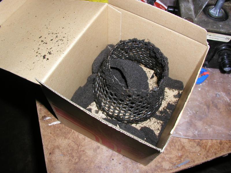

10,257
Yanmar Air Filter
mattinva the filters are notorious for turning into poly sand and flowing into the engine .. here is a shot of my last one .. I now have a good grade of open cell air filter foam on that core.. I don't think that is your problem..
