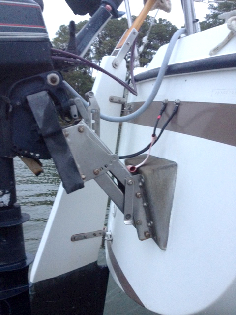

Garelick moun
sPk,
Nice looking job. What mount model # did you use?
I used the longer Garelick 4 cycle mount.
71091: H.P. Rating: Over 7 1/2 to 25. Motor Weight Not to Exceed: 175 lbs. Vertical Travel*: 15 1/2" (39cm) Mtg. Pad: Poly Mounting Board Dimensions W x H x T: 11 1/2" x 12" x 2" (29x30x5cm)

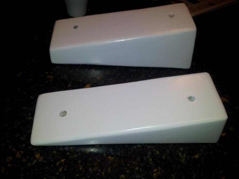

There is an amazing amount of stress and leverage on the transom with the wedge and heavy motor so make sure you reinforce it significantly if you go this route. I noticed a lot of flex in the transom with just a 1/4 re-reinforcement so I think I doubled it to two sheets of 1/4 epoxied. It isn't fun to work under there with epoxy & glass.

SPK, thanks for the bracket link, I was on the site this morning but missed that bracket. I think because I'm on the bay, I'm always thinking SS or nothing. Now I know that SS and aluminum do not play well together, but I'll figure that out when I get to it. I have the ss for 2/stroke mount. The one in your photo is perfect. kent

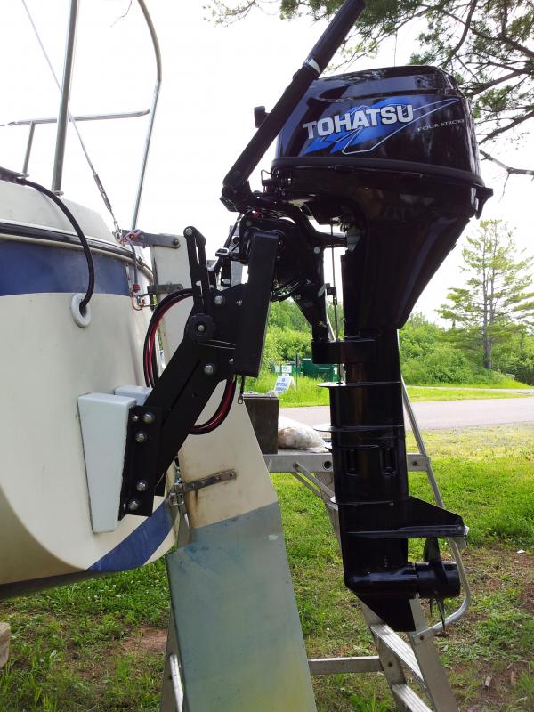

getting in a little late on this discussion but you may be interested in my set up.
Like Ward, I have a Yamaha 9.9....actually it is an exact copy of one from China (Parsun), sold by Coleman, this motor was with the boat when I got it.

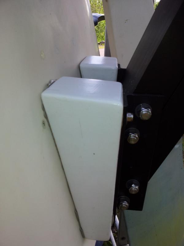

After struggling with it on the original little 2 stroke mount the first year, I had to winch it up with a small chain block!, I fitted a new 15 1/2" gerelick 71091 and have found it very satisfactory. The motor weighs 116 lbs (electric start and remote controls).
I can lower the motor with a one handed push down and raise it one handed almost effortlessly.
I had to make a new FG tapered block to mount on the transom as it has a lot of reverse angle, probably more than the OD 25.
Overall, for my OD 23 boat I think It is too big a motor but maybe good for the 25.
If I had to start from scratch I would go for the smallest electric start motor, probably the 9.8 Tohatsu, smaller and lighter, and the smaller Gerelick 71090.....this would be better for my 23. My set up seems very big and heavy on the back but works good.

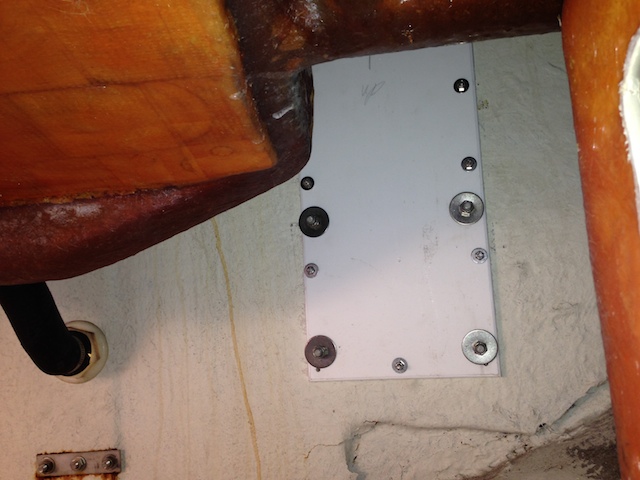

For my backing I have cut 3/4" plywood large pieces that go across the bolts with very large ss washers with smaller ones on top under the nuts. The bolts are long ss carriage bolts (original).
The 9.8 is the largest hp motor of the smaller frame series, the 9.9 is the smallest hp of the larger framed motors that go to 15hp, thats why it is heavy.

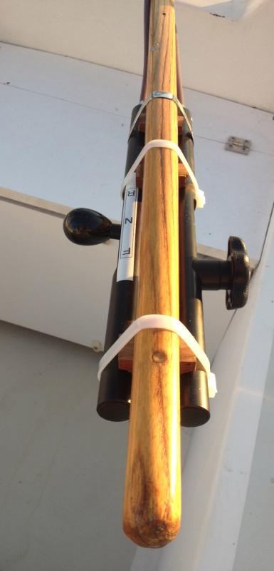

Here is a pic of the mount, I hope this helps you.
