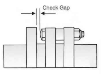

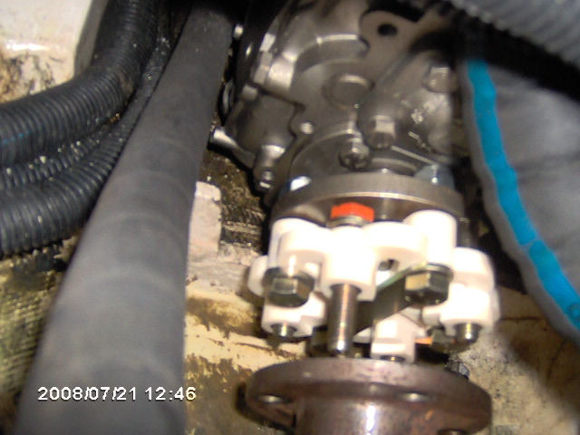

From this I read that the aft part of my engine is twisted a little toward the port. Is it far enough out that I need to adjust? I should also note that I have an R&D Flexible shaft (attached picture) coupling on the shaft and used the alignment marks on it to measure with the feeler gauge (other attached picture).
The R&D Coupling documentation states that the coupling can be used for doing shaft alignment. The red bolt shown in the picture is the one you use to get your measurements as it faces a corresponding bolt on the other surface. The documentation had me make the measurements by rotating the shaft around to each of the point and then measuring between the red bolt and it's corresponding face. In that way you are using the same exact point on the coupling every time and eliminate any flex or irregularities in the flex coupling (i.e. measure at top with red bolt, rotate to port and measure at red bolt, rotate to bottom and measure at red bolt and rotate to starboard and measure at red bolt - then repeat).
[/FONT]PYI said:Flexible Shaft Coupling Installation
PYI said:[FONT=Arial,Helvetica,Geneva,Swiss,SunSans-Regular]1- Roughly align engine and stern gear without flexible coupling i.e. only two rigid half couplings pushed together.[/FONT]
PYI said:2- [FONT=Arial,Helvetica,Geneva,Swiss,SunSans-Regular]Bolt R & D Marine coupling between the two rigid couplings. Tightening details as below.[/FONT]
3- [FONT=Arial,Helvetica,Geneva,Swiss,SunSans-Regular]Check alignment of the engine by placing feeler gauges between the Red Cone Headed Bolt and the rigid half coupling. Repeat for the Same bolt at 90 degrees intervals by rotating the shaft.[/FONT]
4-[FONT=Arial,Helvetica,Geneva,Swiss,SunSans-Regular]If the Gap is the same in all four positions, the engine is accurately aligned. Recommended minimum to maximum gap difference 0.010 inch/ 0.25 mm.[/FONT]
5-[FONT=Arial,Helvetica,Geneva,Swiss,SunSans-Regular]Run installation to bring engine compartment to working temperature. Re-check torque settings.[/FONT]
