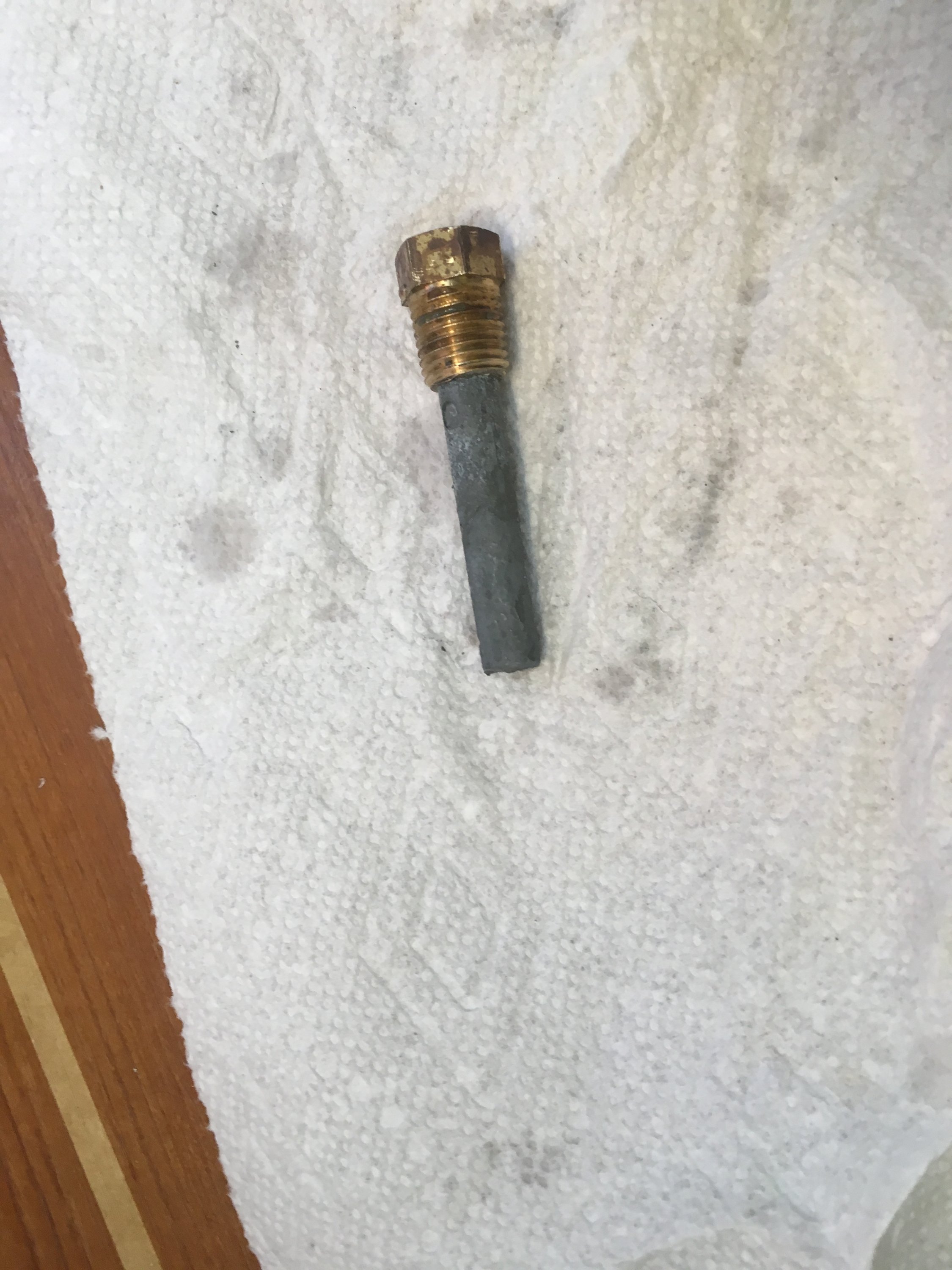

This is also a good time to check and possibly replace the HX zinc if it's looking worn, since you'll be right there. I buy mine on Amazon, CME0.
