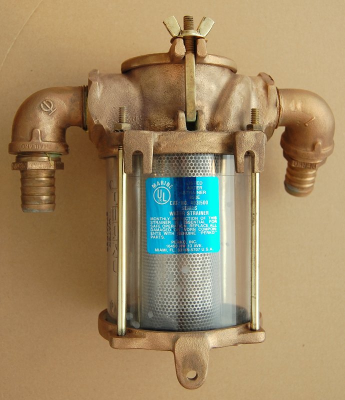

IMHO, you'd be much better off replacing that with something like this:
Photo courtesy of CGedwards. click photo to see item there.

Thats probably $600! im a poor sailor. barely have a boat. Is there a cheaper alternative? whats wrong with the plastic versions? yeah, they arent all nice and bronze, but heck, dont they work?

Yeah, if you get the one sized for a 400 HP diesel it would be... you don't need one that big... and as Maine Sail said, it's less than $200 ($159.95 at the link I posted), and it is far easier to maintain than what you've got and far more functional.

ok, thats more reasonable. It does look like it would do a better job than the little screen disc thats in mine.
