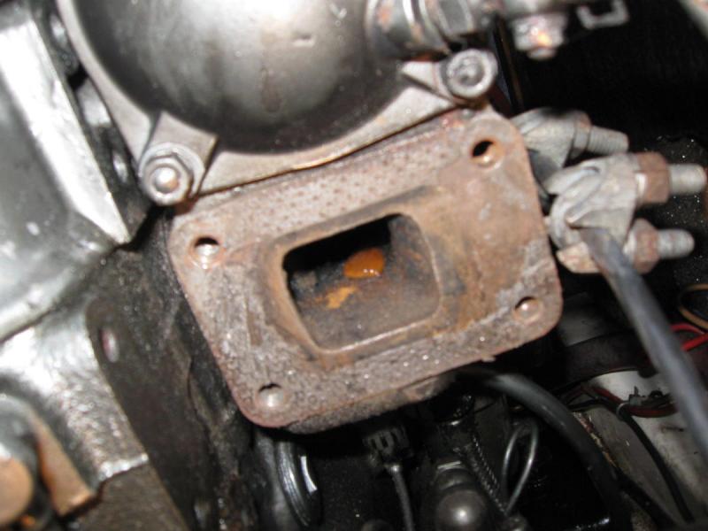

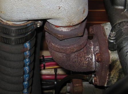

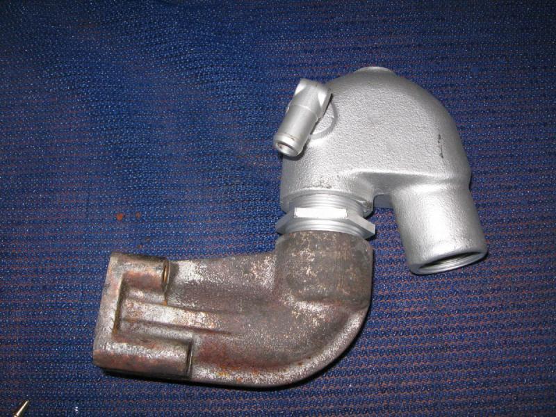

I have a hairline crack in my mixing elbow. Pulling it with the flange that attaches to the heat exchanger. When I re-attach the flange to the heat exchanger, what sealant should I use? I'm thinking permatex #1A
You don't say what engine you have so we can't give you a precise answer. If it's a Yanmar engine, it probably has a gasket as on my 3GM30F.I have a hairline crack in my mixing elbow. Pulling it with the flange that attaches to the heat exchanger. When I re-attach the flange to the heat exchanger, what sealant should I use? I'm thinking permatex #1A
