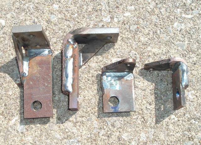

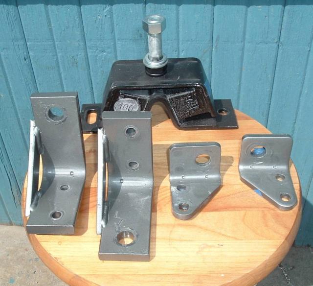

My 3YM30 is a very small and light engine so the 2YM20 should be a good fit. The major difference is the YM is narrow so the mounts do not match the Cherubini's wide bed rails. If you use "Search" for 'engine' and model 'h27_75-84' you will find lots written about your question. Some have glassed rails to the inside of the existing ones. I chose to weld on extenstions(pictures) to span the width. You can see my 3YM30 installation at: http://hunter.sailboatowners.com/in...&Itemid=267&cat_id=38&page=model&mn=37-cutter . There are four topics at the bottom starting with "Yanmar".
